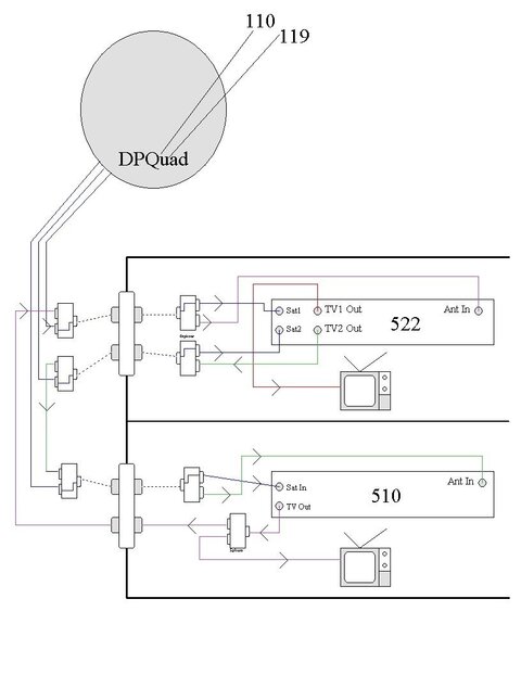

I have made up a diagram to get this working. By my estimate, 6 diplexors and one splitter are needed.
You can skip the splitter by going with component out to the tv and coax out to the 522.
good work BC. That looks like it would work just fine. but the way they have it set up now is that the 522 tv2 is the only feed that gets backfed through diplexors.

The great Idea I agree with but after doing some reading on tech specs this morning (geek alert) I discovered that you cannot send a diplexed signal into the lnbf without bad consequences. Furtunately this situation could be remedyed 2 ways. 1 buy 2 more diplexors and go with my idea, 2 buy 4 more diplexors and a splitter and use BC's way. both should get it done but I think BC's is the best as it gives you an extra tuner.
