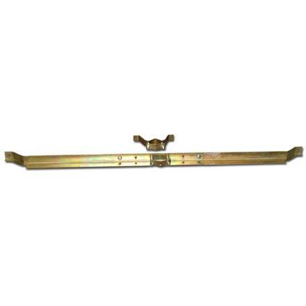

Lazy probably do the cable bury. As for how to mount to a metal roof, this is what I use(see Picture). It is an eve mount kit, and the reason I like it is because it's cheap, easy to install, stable, customers don't object to it being mounted to there house, and it can be used to mount any thing from terrestrial antennas to super dishes.
