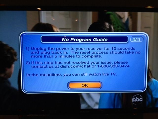

Well, the saga continues. Froze up again during an EHD transfer. I did manage to get a batch of shows over, though...about 6 or 8. Then, during the last transfer, it froze up. I reset. But this time, I saw a new screen:

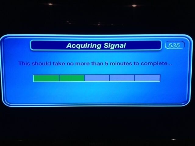

I hit OK and it attempted to boot up:

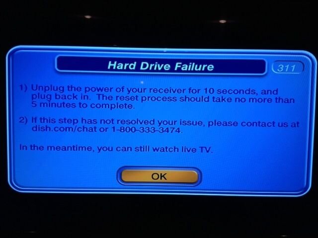

Then, I got the real scare:
When I hit ok, it would go back to the "Acquiring Signal" screen, stop at two green bars, and go back to the "Hard Drive Failure" screen.
No amount of reboots helped it.

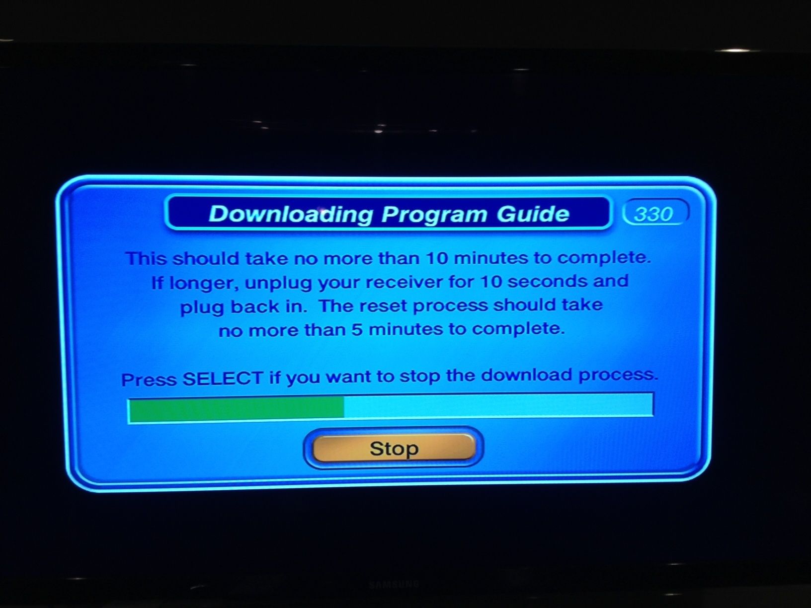

But when I plugged it back in again, low and behold, it came back online! I got this message:
It went all the way through and came back to live TV. I immediately back to pushing shows over to the EHD.
