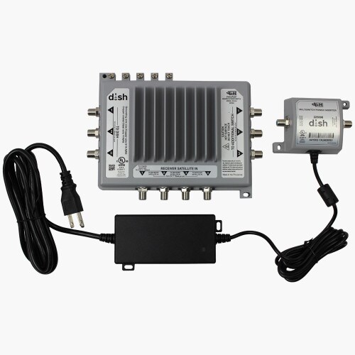

I just discovered this little item on Solid Signal's website. Doesn't seem to be much info out there anywhere else yet.
It's supposed to be a replacement for the DPH42. Hybrid switch, 3 inputs, 4 outputs, and 3 cascade ports to add more of them. I guess for apartments, condos and businesses that need a lot of independent Hoppers and Wallys.

The DPH34 switch is a replacement for the DPH42 switch. It's purpose is to introduce Hybrid technology to Hoppers using legacy satellite dishes and LNBs. I don't believe an SW34 switch exists or ever existed. That is why you were shipped the DPH34. I don't think the DPH34 is going to give you what you want. I'm sure one of our techs will pipe in to give you some guidance.

There is a DP34 which is three DishPro LNBFs to four DishPro compatible receivers.
This is different than the DPH34 which is the same as the DPH42 but for only three inputs and four outputs and cascadable.
To say what's compatible, we really need to know what type of receivers do you have and what LNBFs are on the dish?
SWxx is legacy technology (SW21, SW44, SW64). Can't coexist with DPxx or DPPxx switches.
DP21, DP34 are DishPro which bandstack left and right polarity on a single feed.
DPP44 is DishProPlus which introduces ability to use a combiner to feed two inputs on a dual tuner DPPro receiver with one cable.
DPH34, DPH42 are Hybrid which requires DP or DPP equipment on the dish side and supports Wally or Hopper 3 (and I think ViP) on the inside.
