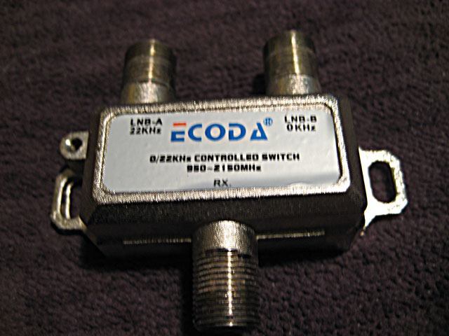

Wescopc recently brought to our attention that he had noted that the 22 ports were reversed on some Ecoda switches that he had in stock. When we compared the switches we noted that the housing cast was different and the f-fitting ports were elongated on the units with the reversed 22K ports.
GEOSATpro partners with Ecoda to import 22KHz switches and we have determined that there are clone 22K switches in the North American market. Ecoda engineers have indicated that their design places the 22K port on the right side port. Ecoda does not source the housing and all units should have the same length of ports.
Update: Other reports place the ports opposite and the elongated ports, so we have an email into our supplier requesting clarification of the products.
Here is a photo of the GEOSATpro cobranded switch manufacturered by ECODA.
0k port is on left / 22k port is on right

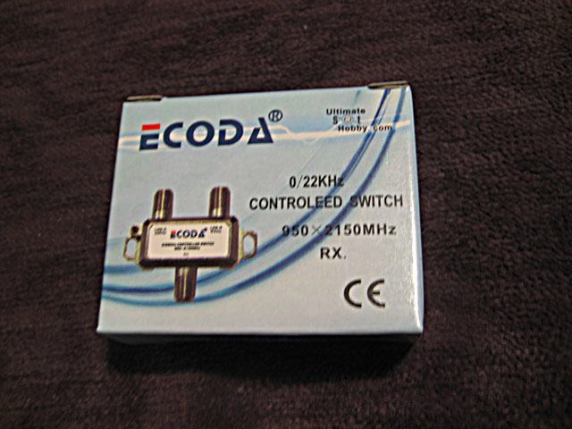

It looks like I was sent a clone on Ebay from "UltimateSatHobby"
I didn't notice the misspelling on the box until just now.
Below are pics of it.

WHAT ?
Can anyone who got an ECODA from Ultimate Sat Hobby a year or two ago, take a look at theirs and report?
Also, can others who've bought the product, let us know when they got it, what the source was, and if it's clone or not?
I'd like to see a picture of an older real switch.

The Final Answer -
Here is the picture right on the Ecoda web site.
If for any reason, that link doesn't work, here is their English web site; the 22khz is under Multiswitch.
I'm not surprised that Ecoda themselves are the source of the bad spelling. :)
