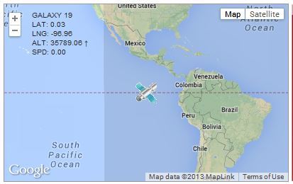

The 97 degree is the longitudinal degree g 19 is set at in orbit
And BTW, it's a good idea to use that location, ie, 97W when referring to satellites across the Clark Belt because the NAMES change from time to time but the locations don't change that often.
FYI, if you use "The List" up the page to verify what satellite you're on it will make things much easier.
gal19.JPGAs you can see from the illustration, the satellite is hovering above the equator at approximately 97 degrees West longitude (several hundred miles west of the Galapagos Islands). When you receive a signal it's amazing to think the dish is pointing all the way down there (just up in the sky).
