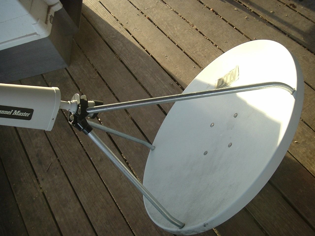

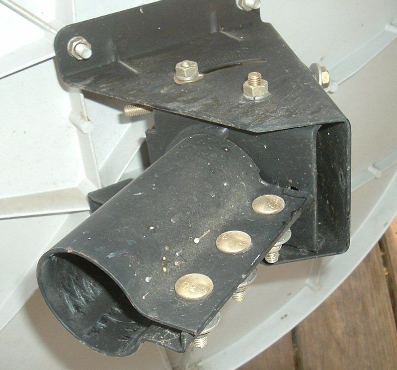

Ok boys, I finally climbed the roof at work and took down the DTN dish they are letting me use. Here is what I came home with. The dish will mount to a big corner post for a chain link fence, which I have, so I for now should be able to get it up and running tomorrow at no extra cost.

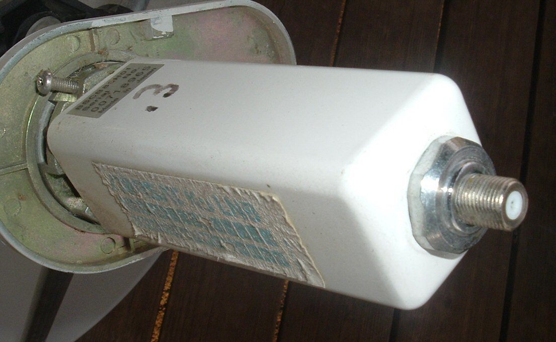

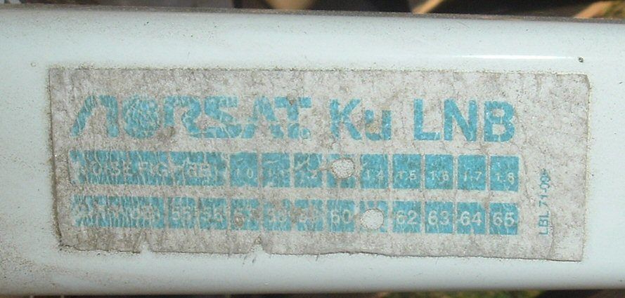

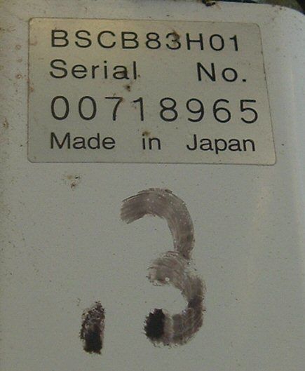

Will I be able to mount this to a motor ever? Just put in a short pipe in the dish, then use a U bolt to hook it to the motor?? Also, does anyone know anything about this lnb? It says Norsat Ku lnb, but other than that, I dont know much.

Norsat is a good make but the LNBF will be old so a new LNBF would be nice, let us know what it says on it, but it should work. Getting the dish on a motor may be more of a challenge. I would remove as much weight as you can from the back of the dish and use your idea to fit U-bolts to it, but no hurry as you want to get a used to your dish by bagging a few satellites first. Check the below link, a member (ziplock) did the above type of dish modification and posted all the details, I would do the same thing with your dish, good luck tomorrow!

OK, so say I did that mod after I got a few sats under my belt, but how you adjust the elevation?

Thats the tricky part : ) If you are using a motor the elevation never changes so you would fabricate it to the elevation/declination found in the motor manual and you are done.
Looking at the above link/picture it looks like Ziplock used screwed rod with a couple of nuts to fine set the elevation/declination.
