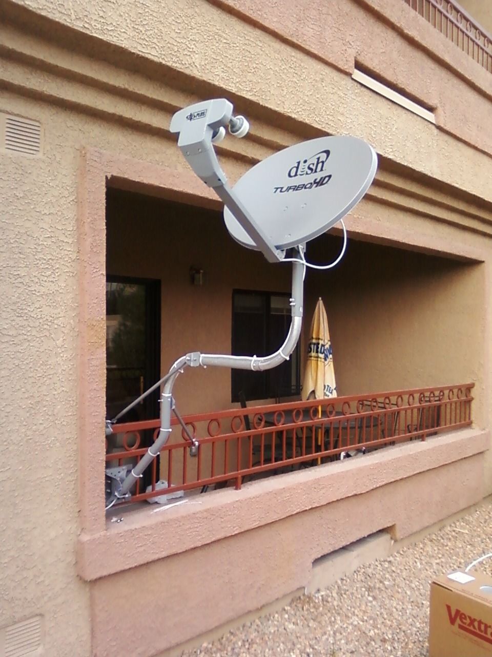

you can do this..mount is in the balcony:D
I don't think he can. I think anything that protrudes past the railing can be considered over a common area and prohibited.
The only safe, uncontestable way would be a bucket or similar mount where the entire Dish including arm and lnb are within the balcony.
Correct the ENTIRE dish assembly must be in your exclusive area no portion may extend past. The "air space" outside your balcony is considered common area.

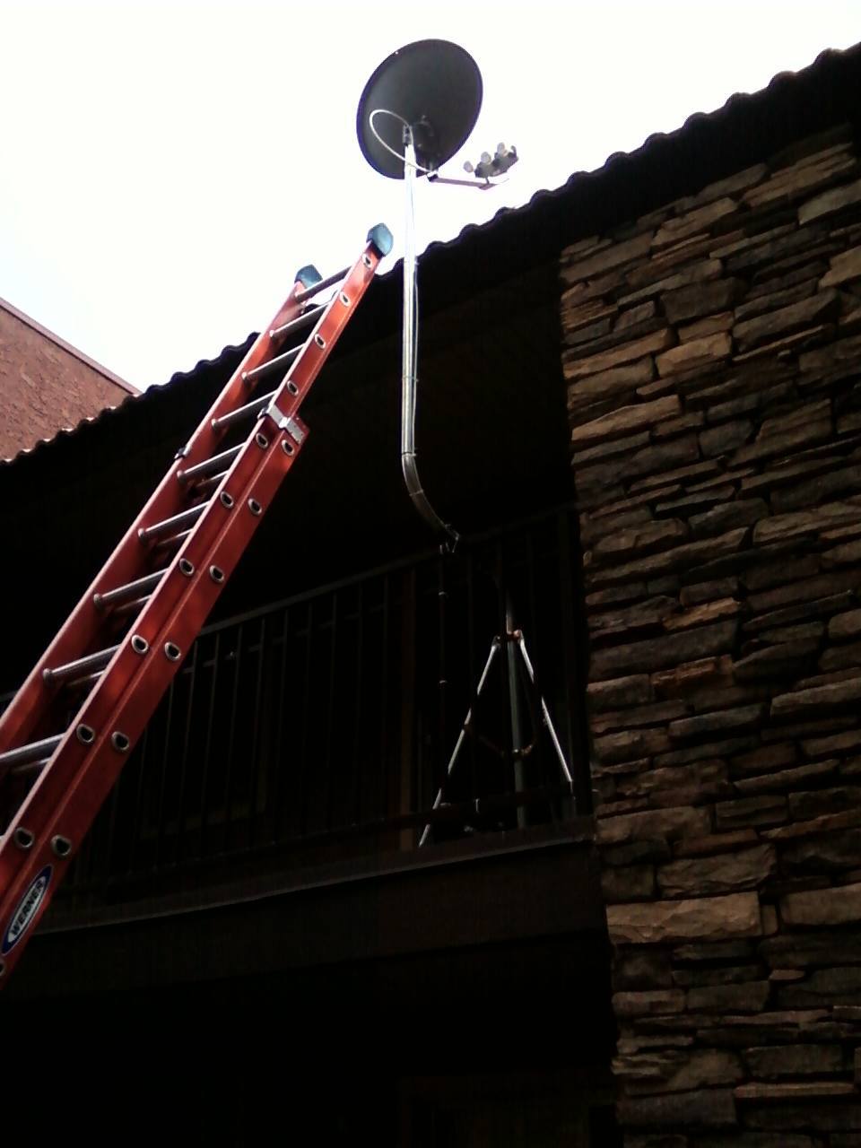

What about the dishes they just arbitrarily took off the roof? OTARD specifically says that if it's the only place the person can get a signal, then that's where it goes. The complex doesn't have space for a dish farm, so that's pretty much out of the question too.
I might be wrong here but as I'm reading this, the roof mounted dishes would have to go as that is a common area and not covered by OTARD
Q: I live in a condominium with a balcony, but I cannot receive a signal from the satellite because my balcony faces north. Can I use the roof?
A: No. The roof of a condominium is generally a common area, not an area reserved for an individual's exclusive use. If the roof is a common area, you may not use it unless the condominium association gives you permission. The condominium is not obligated to provide a place for you to install an antenna if you do not have an exclusive use area.

So, if you read the policy carefully, it says patio rail. Yes, the air outside your patio is considered common area, and there is absolutely no way to do a rail mount without some part of the dish extending past the patio. So they can stop you from mounting to the rail. However, they can do nothing about the dish being entirely on your patio on a non-pen mount.
The roof is common area. And therefore OTARD does not apply. Also, the property owner has the right to prohibit all permanent and penetrating attachments. That's also in the rules.
Once again, the only place the property owner cannot place restrictions on the PLACEMENT of the antenna is within the confines of the tenant's exclusive use space. That limits it to the inside of the apartment or the patio or balcony.
