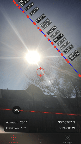

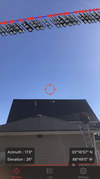

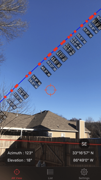

I'm attaching some pictures of Dishpointer app to show what I can see. I basically start getting into trees at 133 and further west, and 30W and further east. Meaning I can see (I think, anyway) 34W to 133W or so. The ladder up to my Dish Network dish was from me repointing from EA to WA

Much will depend on your interests as to what you buy to restore your hobby.
You mention not needing HD, but all receivers these days output HD, and you'll be amazed at the quality, even if all you do is compare network feeds (plenty up there, great if you have problems with local OTA reception) to a local station's rebroadcasting of them. The nice part today of FTA is cost is down. There is an amazon link on this site that will help support Satguys with your purchase, other than that, there are members with great offerings in receivers, dish movers, and LNB's.
A used MicroHD is a very stable receiver, so is the Amiko Mini HD if still available. Most new models of other brands are very reasonable, some with 'net access, and the DVR function is achieved simply by adding a hard drive you may already have laying around.
103 ku with Cozi-TV and the NBC feeds OFTEN have uplinks going for news reports and individual stations, but C-band, in my opinion has become where most of the "action" is. During major events like the last huge hurricane, that satellite had TONS of live coverage from stations in the affected area.
Since you're using one, you'll want to seach "Primestar dish" on this site for lots of info on people that re-purposed them. I'm not familiar with their LNB's compatibility with FTA. I have not. worked with an original (Primestar) one...but they are very similar to Ku dishes used by DTN weather/ag services which I have used, just different LNB's are applied to each proprietary system.
Good Luck! Ask Questions! Enjoy, and welcome back to FTA.
