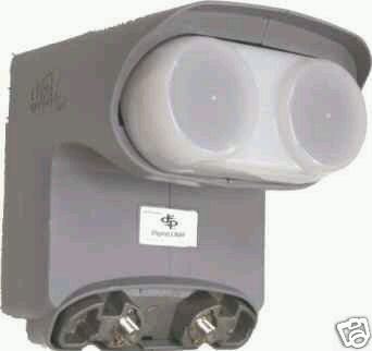

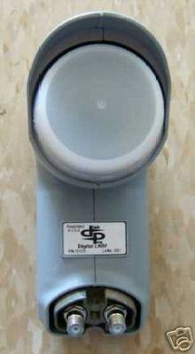

A dual only looks at one sat, a twin looks at two sats. Here are some pictures the first is a dual the second is a twin.

A DP "DUAL" only sees 1 satellite you need 2 of them if you want 110 and 119. You also would need 2 six foot dishes one aimed at 119 and one at 110. With that sized dish yor DP LNB probably isn't aimed accurately at the satellite, with the narrow beam width less than a 1/64th inch of movement could miss the satellite.
