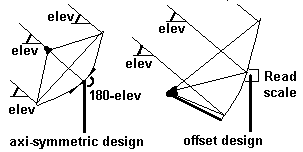

Depends on the dish type, give us your zip code and we can give you the exact angles to the satellite!
An offset dish seems to be looking lower than where it actually is. (See below)

What would be helpful would be the info for a strong transponder on that satellite. I also am having trouble finding it.
im not too good with these numbers , i never get them. how to do I adjust the dish? to 112.5 115.6 14.9 -43.7 , i looked at the back of the dish and the numbers seem different??
thanks
The numbers you are refering to can be found on a compass, you can buy a compass fairly cheap at Kmart, I bought a Coleman Lensatic Compass for under $10.
By the way Lensatic Compass is very accurate, try to use a string if you can and stay away from the dish when doing so because the metal from the dish will throw your compass off.
Now as to the numbers 30.0W 112.5 115.6 14.9 -43.7
115.6 is what your aiming for as to direction you should be pointed to using compass.
14.9 is the elevation setting.
-43.7 is the skew which can be adjusted by turning the LNB clockwise for negative - 43.7
