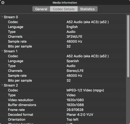

The Plex server is getting the OTA recording from a SiliconDust HDHomeRun Extended tuner (SDT). It records in .ts file format which the HHM doesn't recognize so it has to be converted to a .mkv file which the HHM has no problems with. The server is hosted on a Mac computer. I have an automated process which takes the .ts file, converts it into a .mkv file and put it in a media folder accessible to the HHM.
Here is the problem. There seems to be a coding error in the HHM. SDT records all broadcast information (CC, SAP, SS) SAP is a second audio track that can contain a different language or another english track which has an audio description of the action going on in the scene along with the regular program audio. Also it's in stereo, not SS. HHM is playing the SAP channel instead of the primary audio. If there is only one audio track it will play that track, if there are 2 audio tracks it will play the 2nd instead of the first.
There are no settings for the HHM to select which audio tracks to play. There are Hooper setting which control Hooper viewing & recordings. All the Hooper setting are set to playback primary audio, SAP is turned off. There are no problems with anything coming directly from satellite on the Hooper.
This is a unique problem well above the pay grade of the primary level tech support person. I was hoping to get elevated to the next level but my rep was convinced that with all the Hooper settings set correctly to not pass SAP audio that the problem is with the media server not the Hooper. She begrudgingly submitted a feedback report (ID 765414) which I'm sure no one will look at. Here is why she is wrong:
TV's: There are 4 TV's hooked into the Hooper. The main TV is a LG 4K, which is connected to the Hooper via HDML. The other 3 are connected by a dedicated wired network, no Joey's involved. They get their connection by the component out of the Hooper which is then sent as 720P over Cat 5 (generic term). All TV's have SAP turned off. None of the TV's have a SAP problem with OTA signals or from Hooper recorded or live broadcasts. All 4 TV's are picking up the SAP channel when the Hooper is playing a file by the HHM app. Conclusion, SAP is coming from the HHM app on the Hopper.
Recorded file: Playing the file with VLC media app on the Mac computer which the Plex Server is hosted, you can choose which audio track you want to play. Primary track is English SS. Secondary track is English with scene description in stereo. Both audio tracks are present on the video file that is loaded on the server. I also made a test file which I put music on the secondary audio track. Guess which track the HHM played. I had a music video . . .. Conclusion, the HHM app is playing the SAP track instead of the Primary Audio track.
Plex Server: The LG 4K TV has a built in media player which is more robust than the HHM. It will playback 4K files off the Plex Server, HHM won't. If I'm watching the main TV I'm going through the built in player. Same network, Same server, Same DLNA type connection. It plays the primary audio not the SAP. My iPhone's, iPads & AppleTV have the Plex Media app. This is on a different network (WiFi or LTE vs the hardwired network that the Hooper, TV and computer are on) but it's the same Plex server. Primary audio is played not SAP. Conclusion, only the HHM app on the Hooper is having trouble selecting the Primary Audio track, all other players default to the Primary Audio track.
The HHM has a coding error causing it to default to the SAP track. It should follow the setting of the Hooper. If not that, it should default to the primary audio track. This should be easy to diagnose, it's not a once in awhile thing. It happens all the time.

Audio channels, in addition to numbers, also have a descriptor (English, Spanish, etc). Are both of the channels labeled "English" by any chance? I'm wondering if the HoPper is looking at the description instead of the number and getting confused because they both say "English".

Sam_Gorden I don't see anywhere with in the Home Media app to see different audio tracks let alone names. The VLC app on the computer lists the audio tracks as English and Spanish. On the Spanish track which Home Media is playing, is English with the blow by blow description which is very annoying.

Here is the media file information on the file that Home Media Player is playing the SAP channel. Spanish is the English audio description track, as designated by the American Council of the Blind.

The SAP issue I had and it happened during file conversion. It was a coding name thing. I started with VLC, but it wasn't clean with conversions. I used PLEX on a Mac and the PLEX app on my TV to playback. The Hoppers have been too flaky with external playback. Even the EHD doesn't always work as it should. It became such a pain that I haven't done it in ages. Also since being an Apple Beta tester, the OS releases would get in the way. And since it's not an iTunes thing, Apple doesn't care.
