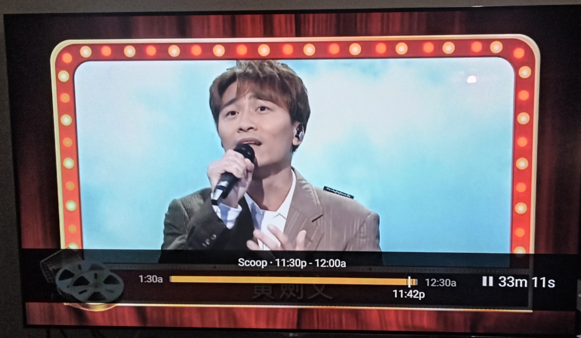

3) As seen in the photo below, we all know the buffers are 1 hour but as seen in the photo, the buffer appears to start from the point of when the Hopper started buffering the channel since it is 23 hours per the photo so the length of the buffer is wrong as well as the start time on the left which should never exceed 1hour or 60 minutes.
4) Another issue using the photo above as a example is that sometimes the video will freeze when either rewinding, forwarding, replaying, skipping and then what eventually happens is using the above photo for example, it will lost the entire buffer even though the 1:30AM to 12:30AM bar is there but the yellow will be empty except from the time when the live buffer shows video after unfreezing, basically it's similar to someone just changing to that channel except the bar will still show the 23 hours but without the yellow before the current buffering.
5) H383, H385, H386 and possibly earlier version(s) I may not be aware of has this issue where randomly, as we all know there is the 1 hour buffer on the current channel but let's assume the current time is a new program which was on for 10 minutes, it will not allow rewinding past the start of the current program as the buffer would be gone for anything before that part so one can only rewind back to the beginning of the current program and not the previous program even though the Hopper 3 was always tuned to the channel for the entire 1 hour or 60 minutes and ofcourse the bar would still appear like the photo above except the yellow would start from the time of the start of the current program and nothing before that.
