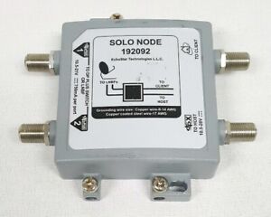

That "Switch" is actually called a Node.

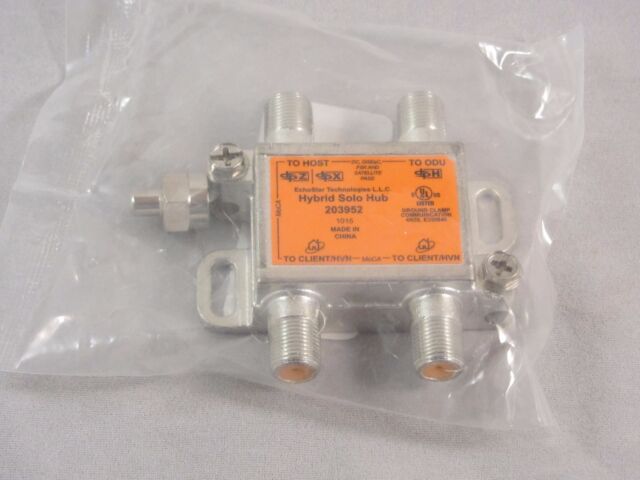

In some manner, the Joey 3 is hard-wire connected to the Hopper 3. That's my question: how is this done? A multiplexor/switch?

Am I correct in assuming that my configuration is no different than any other Hopper 3 <--> Joey 3 hard-wired configuration except that instead of the hub being inside the house close to the Hopper 3, it is instead up on the roof so that it can connect easily to the existing coax?
You are correct. The hub can go anywhere the Hopper/Joey coaxes are. Your coaxes are on your roof. Mine happen to be in my garage so my hub is located there. I have a bit of a different configuration than you, my LNB is not a hybrid so I have a 42 switch to add in the hybrid required for the Hopper 3. My 42 switch happens to be located at the dish location on my roof. That was done to prevent the need for another coax run from my dish to my garage. The power inserter for that switch is located in my garage.
The hub is placed where the homerun or a faction of a homerun is found. Inside or outside has no meaning
