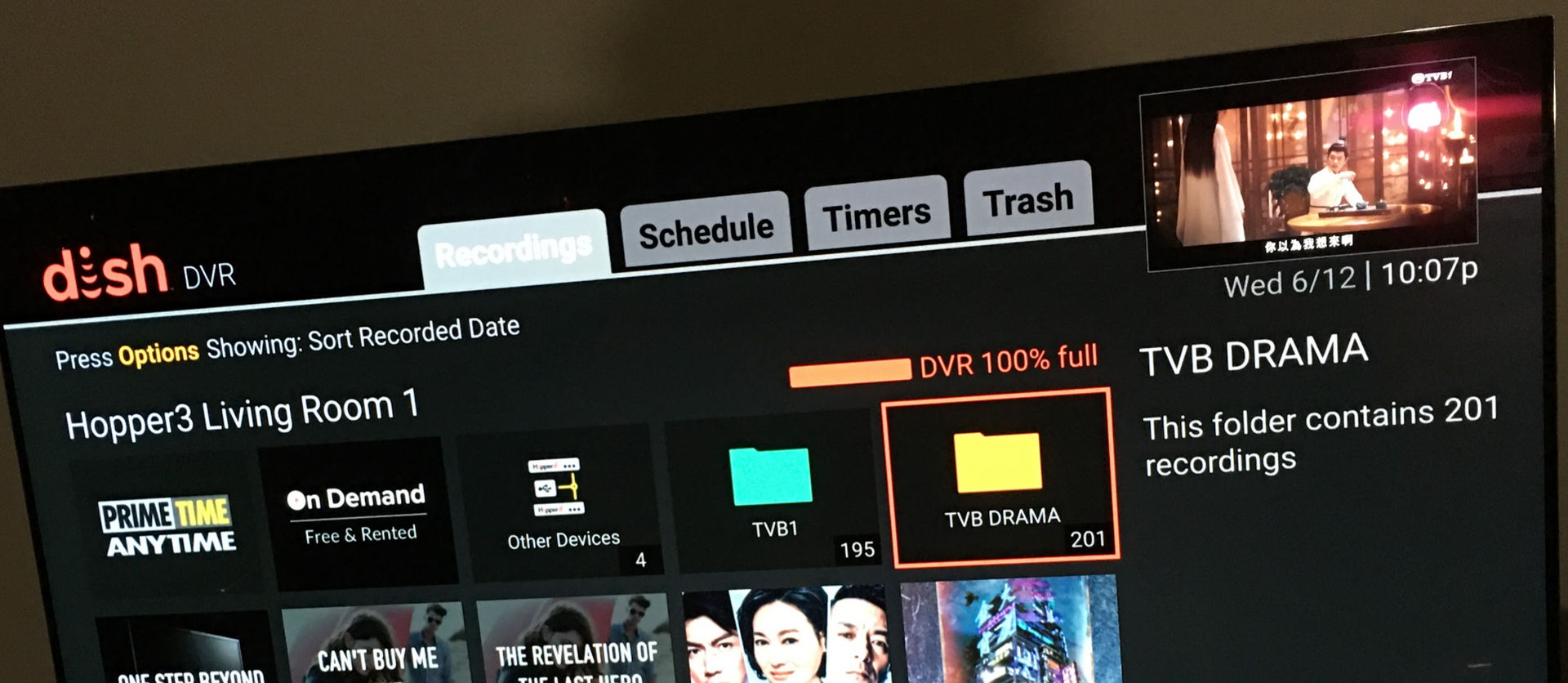

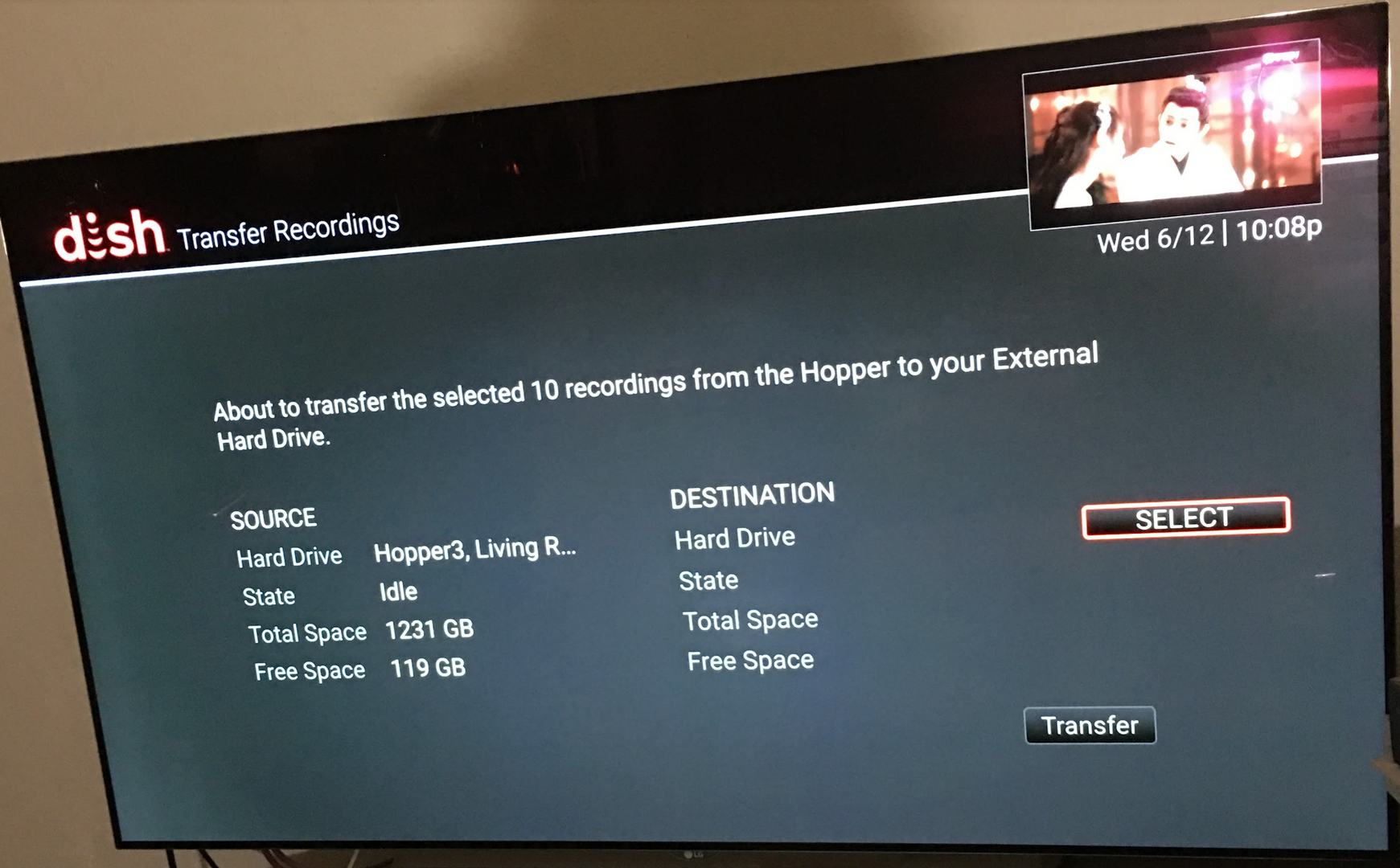

Josh.M and brittanygarden - In addition to the above, the 119GB/120GB HDD space remaining on the internal HDD is seen as 100% full issue, here are screenshots below:
It will have the popups of the HD is full and all recordings halted even if the DVR % full was 79% for example even though the % did hit 100% after a few days. How I found the remaining free space was selecting videos to transfer to a external HDD so it seems like the last 119GB of space of the HDD is not usable for recordings:
