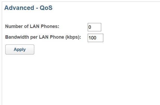

Just looked at the spec sheet for NVG44x (which is the family the NVG443B seems to belong to) and it lists QoS functionality. So either Frontier locks the option on there modems or you talked to an unknowing tech.
I thoroughly searched the settings of the NVG443B modem/router on the browser 'portal' page, and the only QoS settings available were the following (which was confirmed by my ISP technician)
Just an adjustment for LAN phones, no settings for limiting other wireless device bandwidth. I've gotta get my own router. the Netgear R7000 has been mentioned. I'll check it out.
