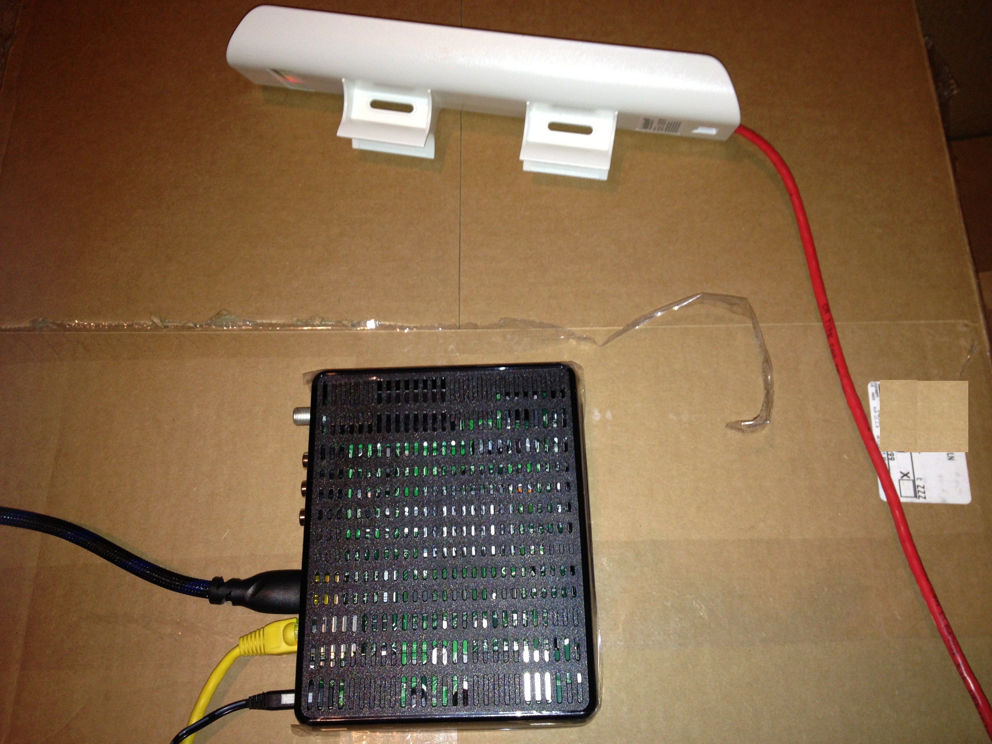

Here's a pic of a wireless PTP layer2 bridge using some Ubiquiti nanostation's.
Working like a champ this is awesome. I'll get more pics posted.

I went downtown last night and went on the roof 18 story bldg and then drove over to IN on a hill and had a successful 3.2 mile link was watching HD. Very cool that we have flexibility like at a lake house down to boat dock or on a horse farm etc..
Freggin audio out of sync a lot!
