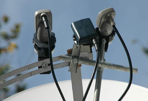

I have used two different types of brackets (some in modified form). The attachment shows an example of both when I had LNBs pointed at AMC3(87), IA5(97), and AMC4(101).
The big difference between the two was that the bracket on the left already had the tilt angle on the LNB holder, so the only adjustments to be made were up/down, side to side, and forward/back. The bracket on the right was harder to aim, as you also had to add the tilt angle to the LNB. As well, it was easier to make minor adjustments with the bracket on the left, whereas with the bracket on the right it was very easy to screw up the whole thing and have to start over! One advantage with the bracket on the right was that it could get closer to another LNB as the LNB holder was not as wide as the other one (hence its use for AMC4).
I have also used a LNB holder from the bracket on the left, and used a shorter and more lightweight piece of metal to mount it on. Just recently I have taken a LNB holder from the bracket on the right and made a holder for it (with the correct tilt angle) and mounted it on a piece of lightweight metal.
