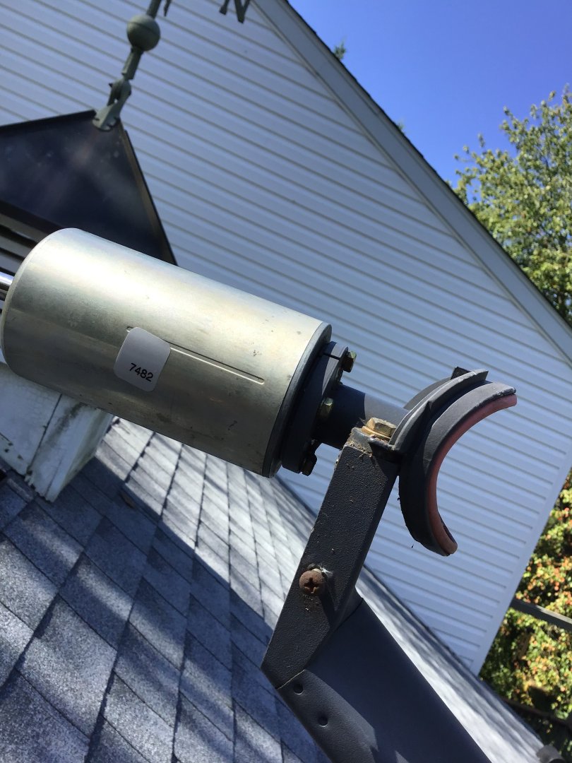

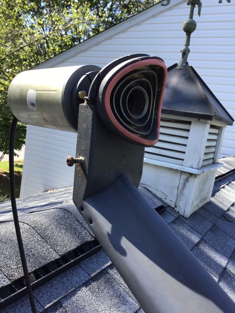

Anyone recognize this and know what LO to use? I acquired a free 84e at a yard sale and am currently on my roof with it. Nothing is coming in so I figure I have a setting wrong on my meter. The lnb has a single output. TIA.

You already figured it out, that's an early standard single output with 10750 LO.
