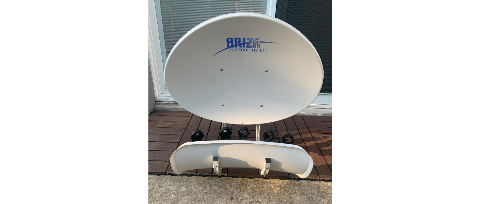

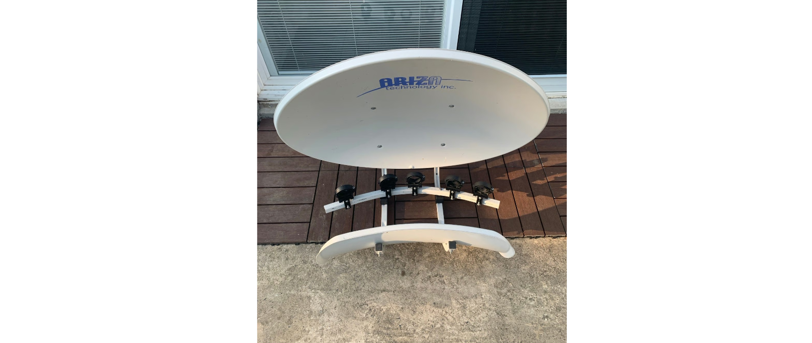

Probably too small for use these days, but i wanted to post in case anyone wanted to try, and for newbies who maybe have never seen one.
This thing looks like new, and the price is pretty reasonable (even the ship cost).
BTW, this is not mine lol, it's a listing i came across.
Check it out.

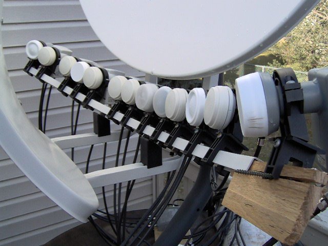

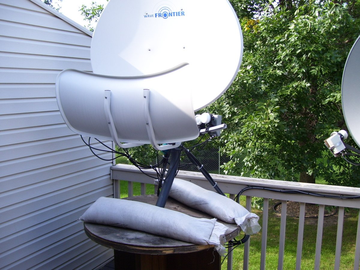

I had one back in the day. I'll try and find the pics I have of it and post probably tomorrow. Toroidal T90
At the time it was nice as I had multiple FTA receivers and VCR's hooked up recording tons of stuff. It only had a 40 degree arc so had a separate dish for 123w at the time (when it had the multitude of networks)
(The arc was 72-112 and after 110w there wasn't anything good until 123)
Well, I know you think this is odd but I used to get a special CH from Spain by turning a one-meter dish upside down so I could see the bird at a higher angle to reduce the ground noise it was so low, and the LNBF was the same but not cir but V-H so I would take a dish one and pull out the Diartic plate and worked fine it drove all the copy cats nuts. The CH was hot because it was speaking Portuguese

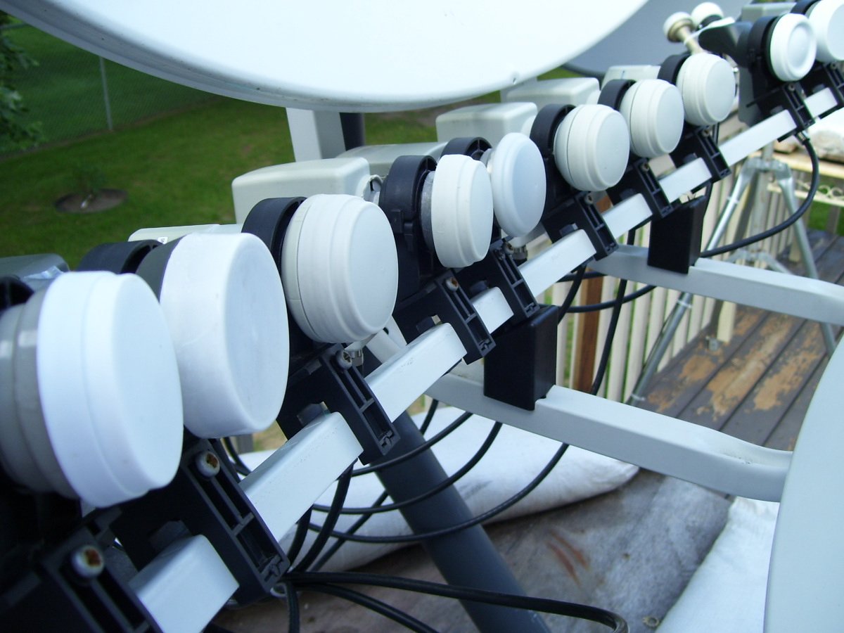

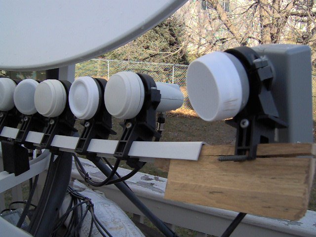

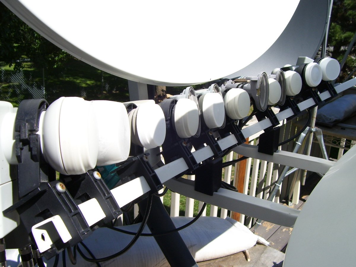

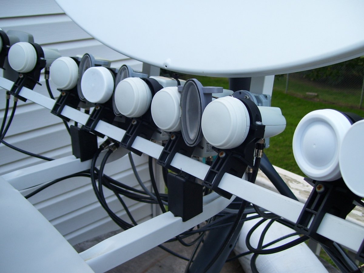

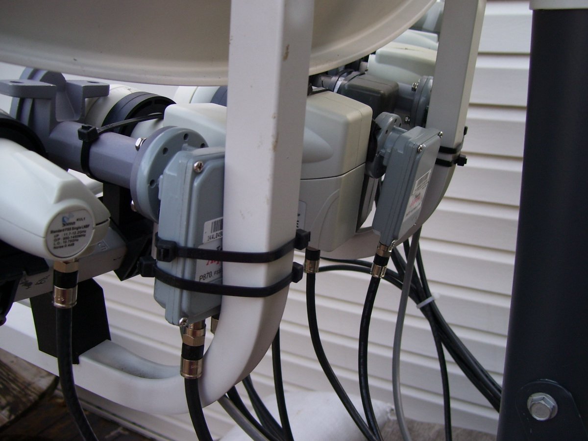

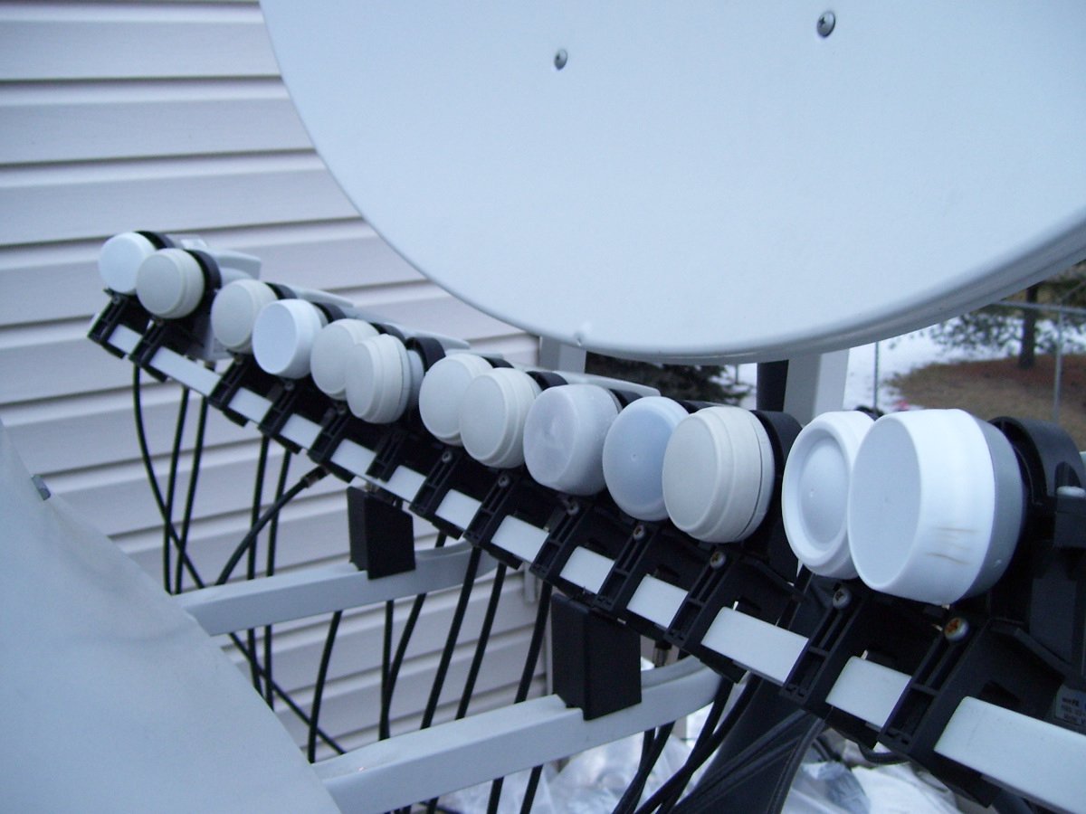

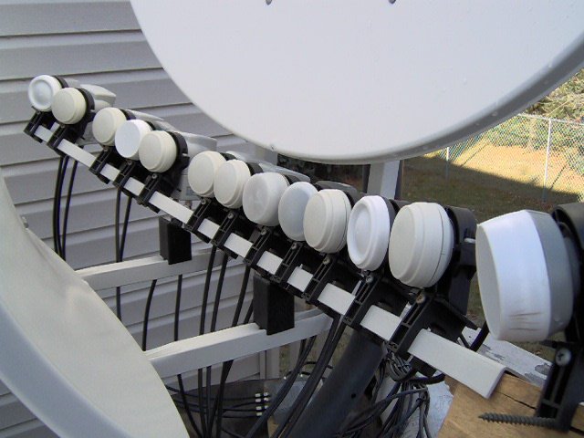

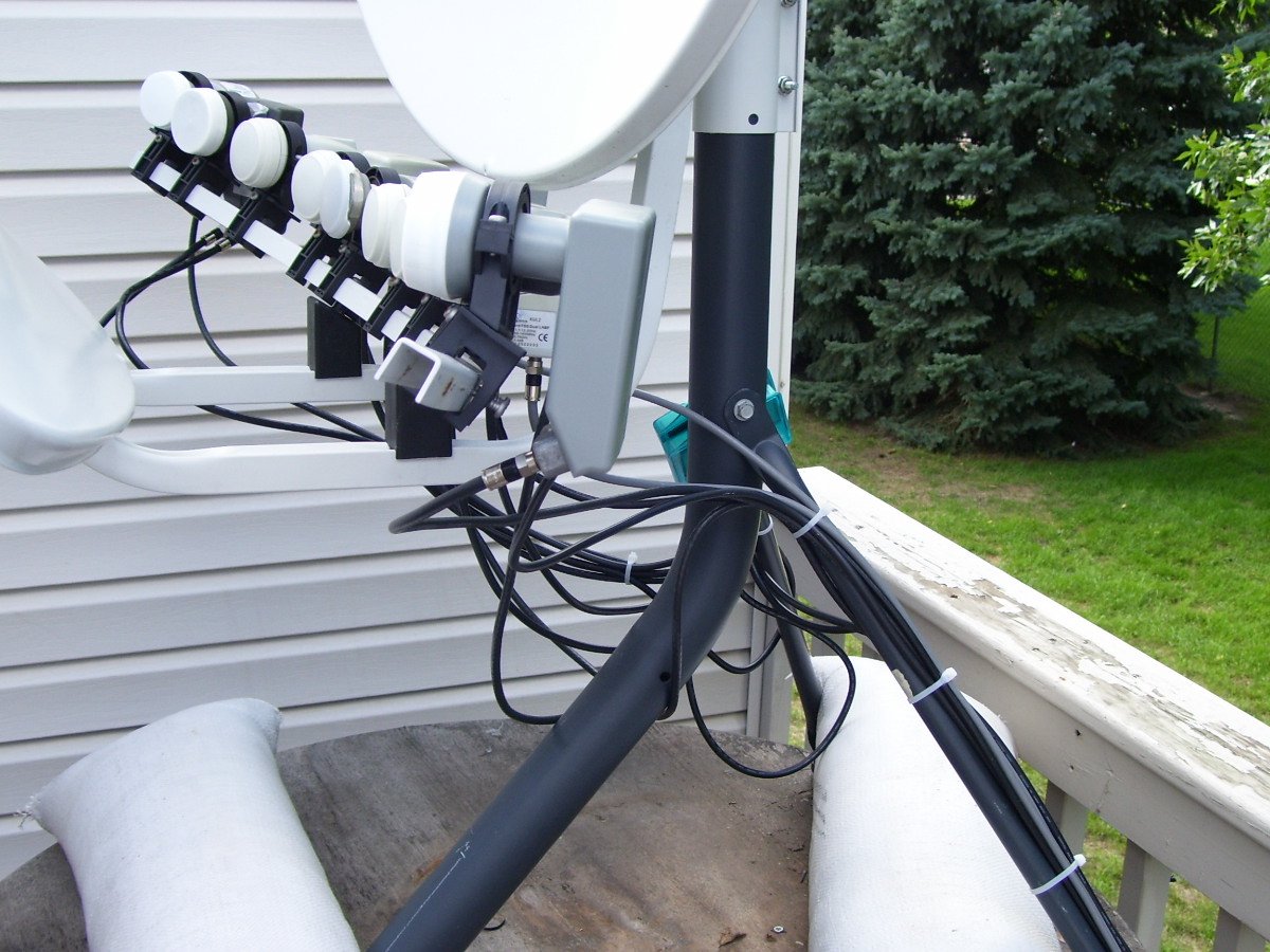

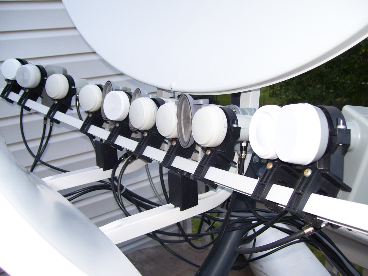

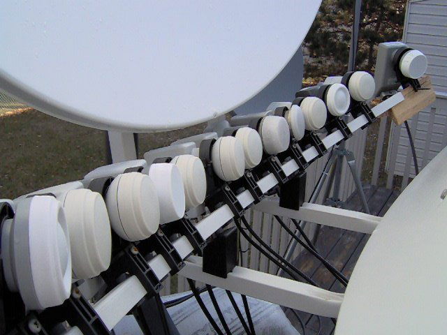

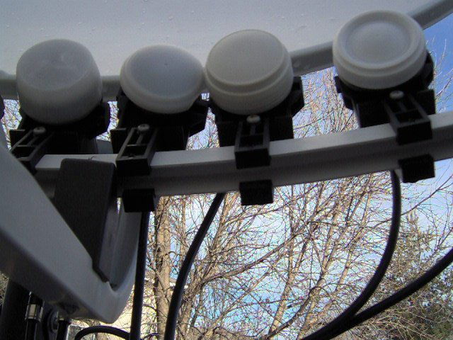

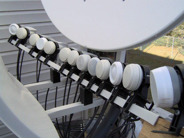

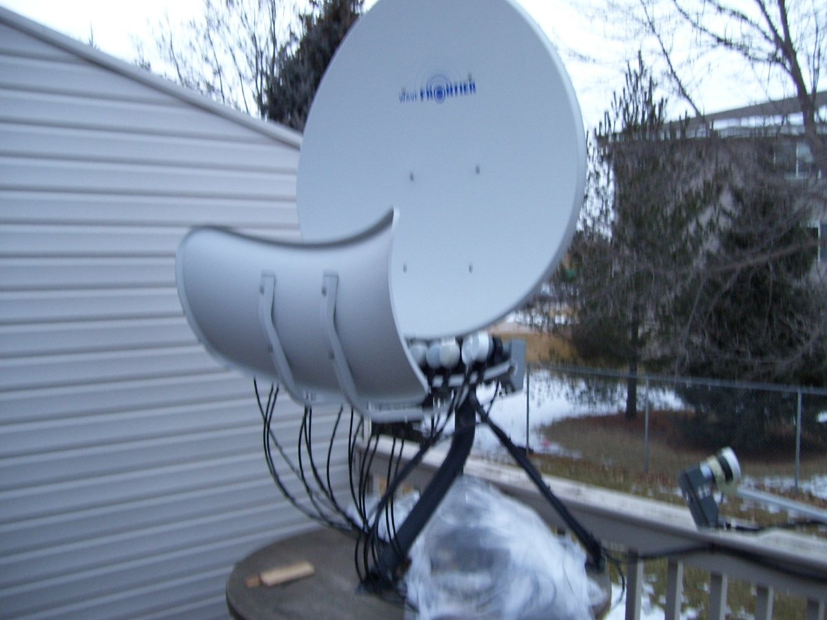

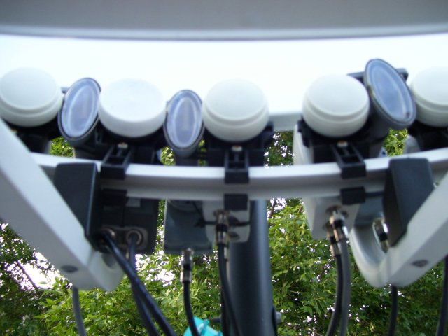

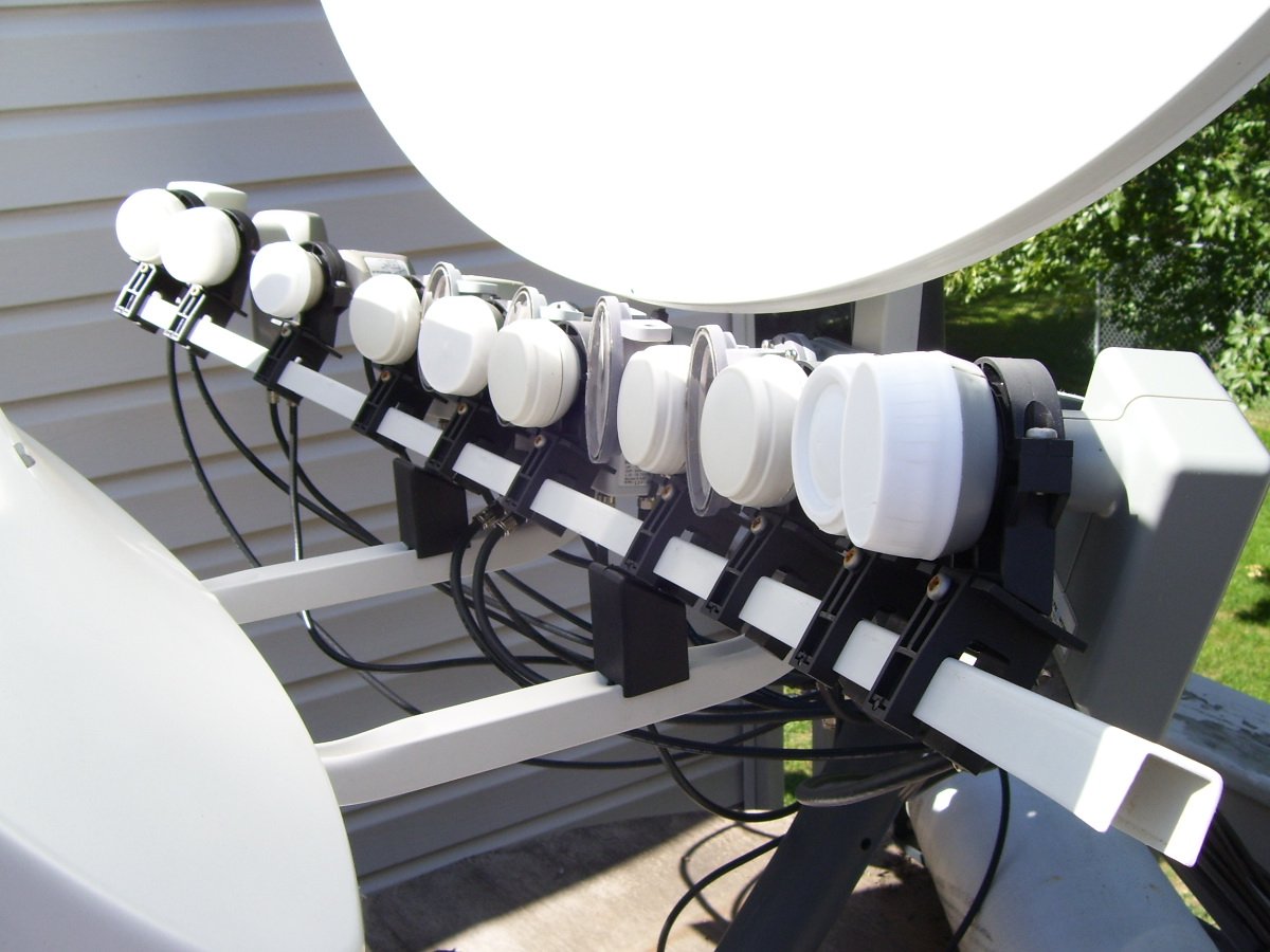

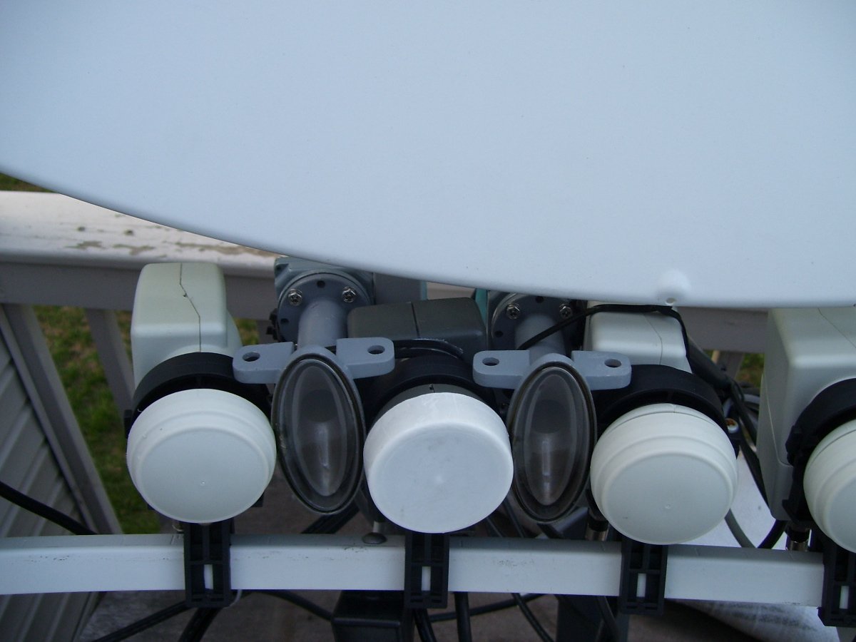

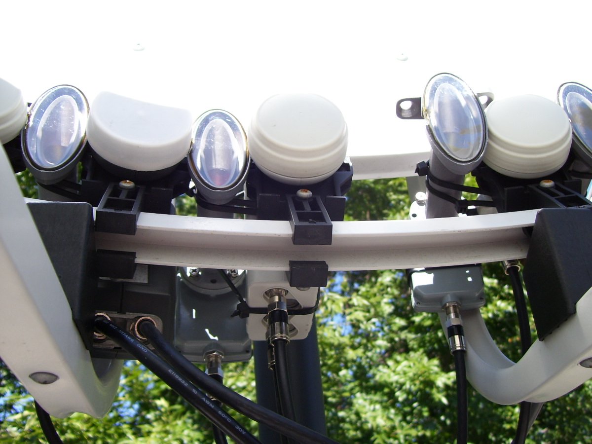

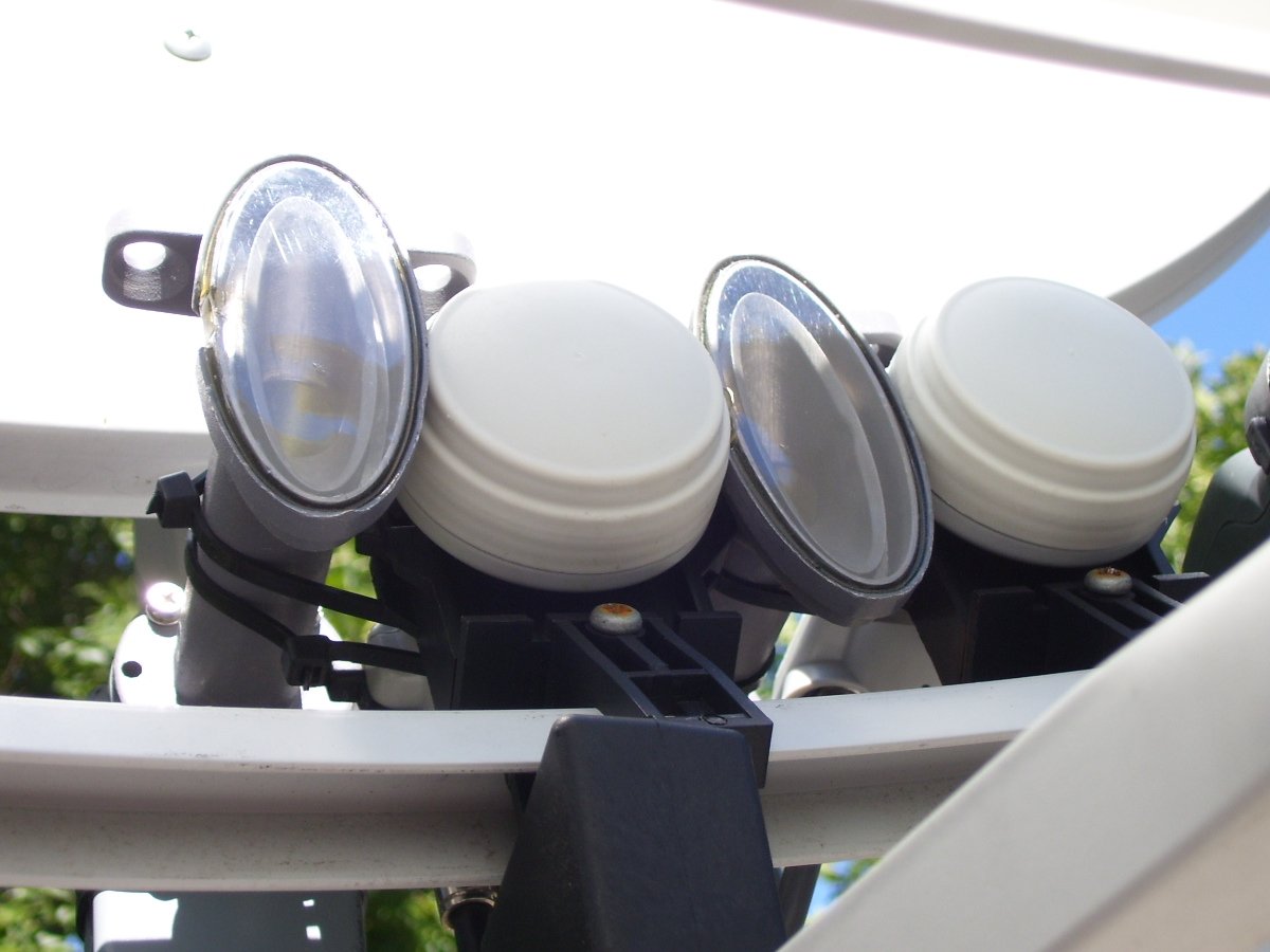

I found the pics. I had a bunch of L:NB's for it and added the "slim" LNB's that were available due to the regular LNB's having a 3 degree separation so could cram a thin LNB between them

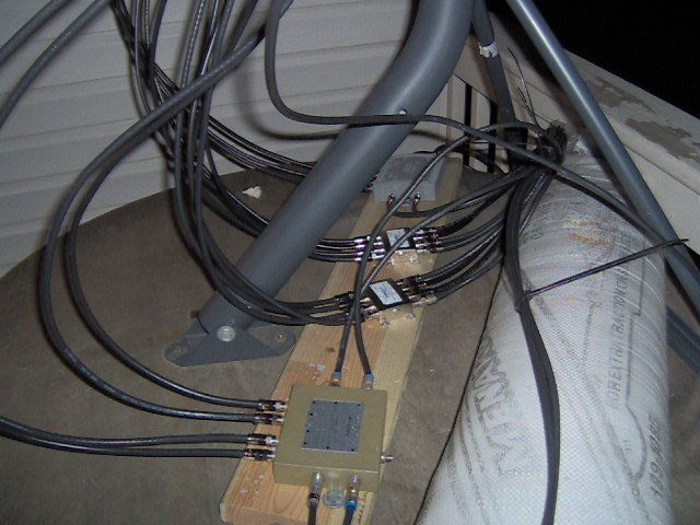

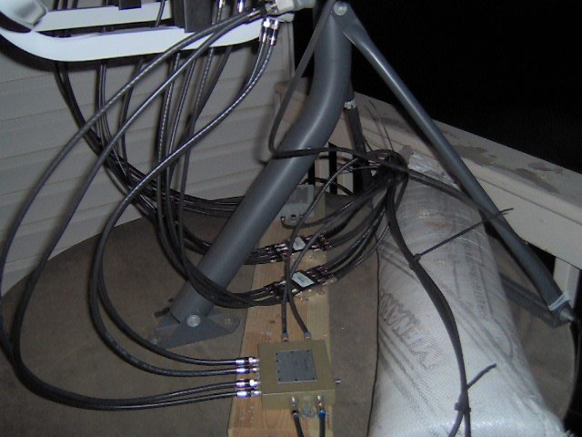

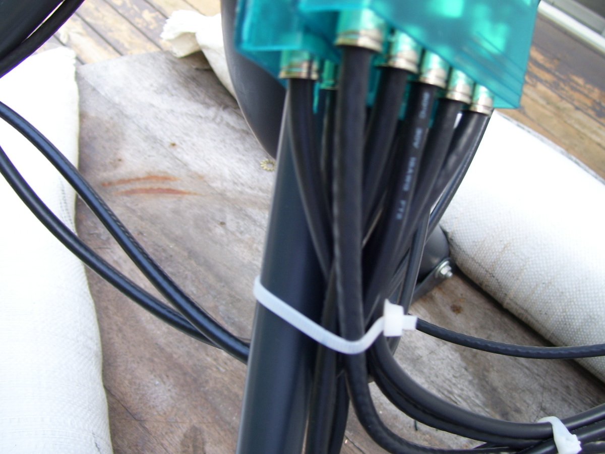

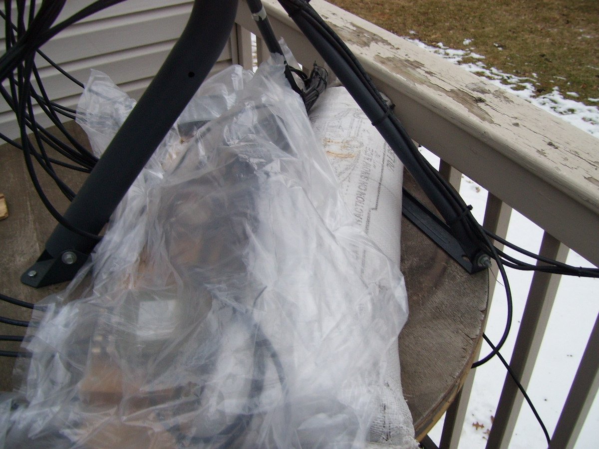

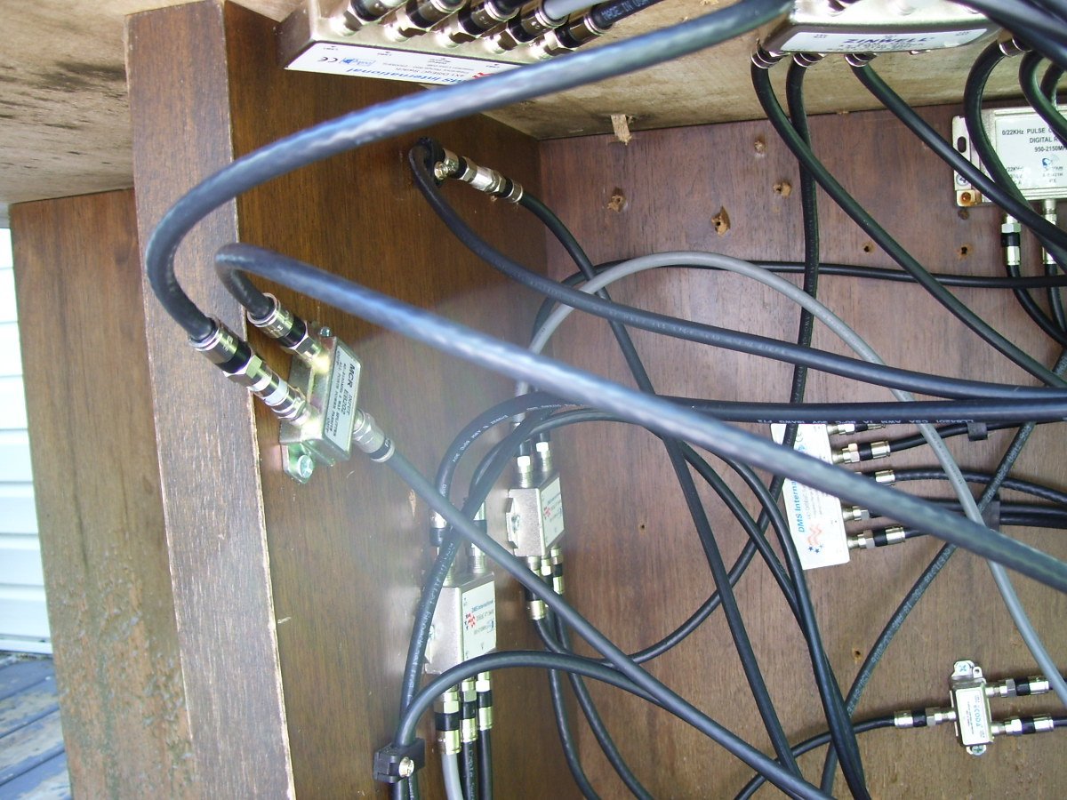

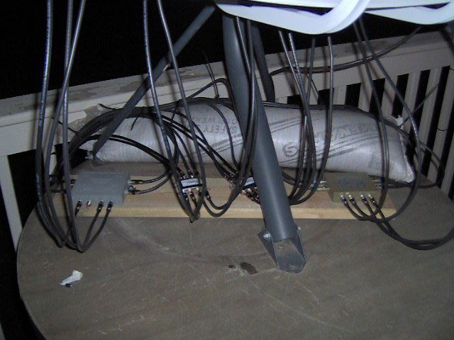

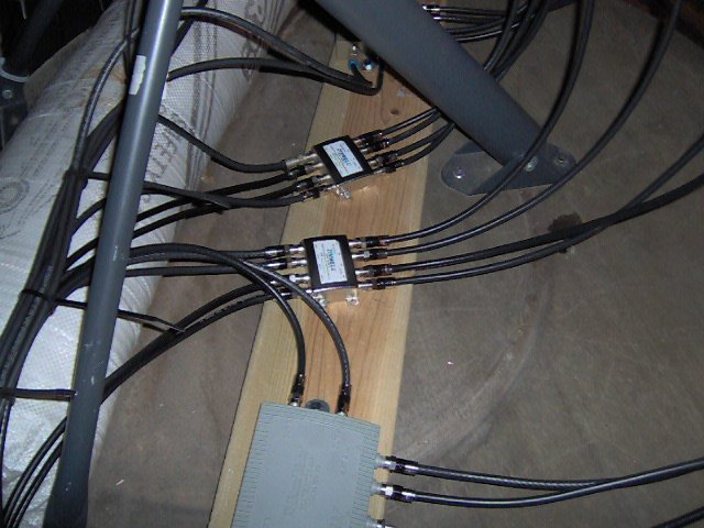

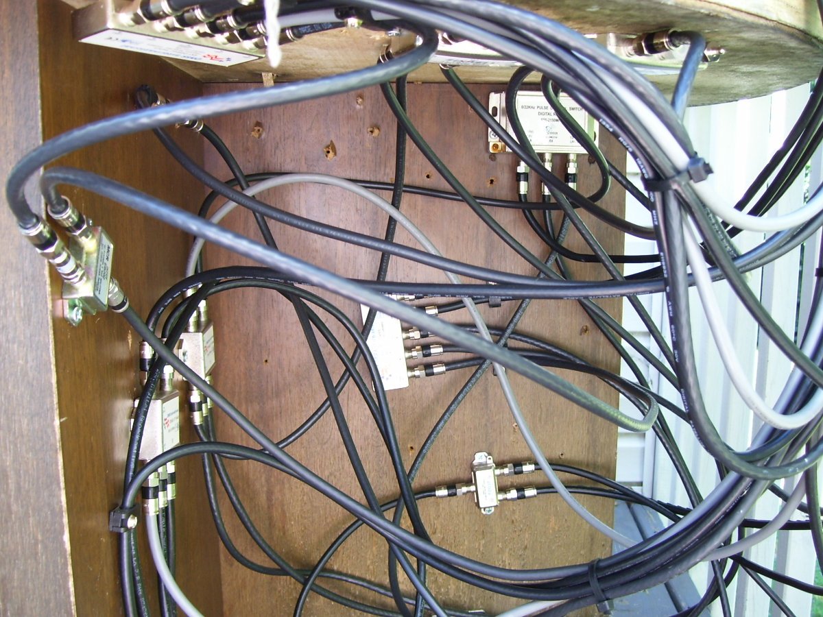

Various pics from times I changed the LNB's around. Had all the switches outside under some plastic (being in MN its needed)

and yes I had switches UNDER that table too in the open. No issues
Are the "thin" lnbs still made? Would be pretty handy to get 97/99/101 all on one dish. I've seen on here where some have diy'd by cutting the cover to make it slimmer.
