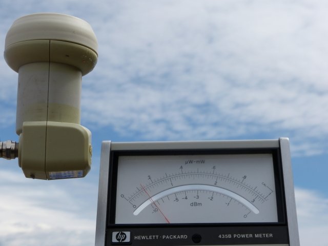

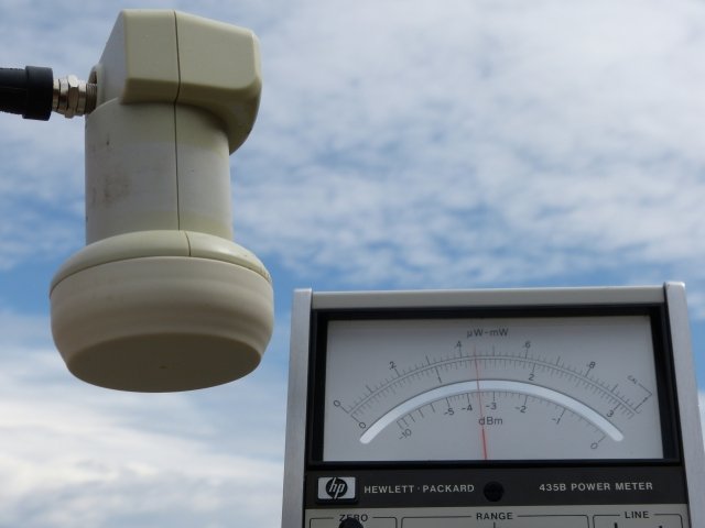

I'm no expert (although I was a tech at a 25m radio telescope for 27 years), but I agree with Brian. You need to separate out all the factors involved in system noise temperature.
About 11 years ago I measured the difference between cold sky and warm ground using a Geosat Pro SL1 PLL LNBF. The difference was 5.4 dB. I also tested a number of other Ku band LNBFs, including from Norsat, but the Geosat was the best of the LNBFs that I had at that time.
Once you get a number for each LNBF, I'd then try them with the reflectors and figure out if there are focus or alumination issues.
Reactions: holland-observatory
