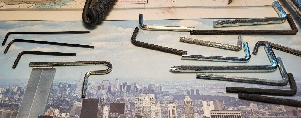

How many Allen keys does it take to fix an LNBF? More than I have...I searched through my collection but could not find one to fit the LNBF screws. The screws were also too tight to use a small slot screwdriver to remove them.
So I unscrewed and burnished the female F-connector probe tip and re-installed the LNBF on the dish. We'll see over time if the issue occurs again.
