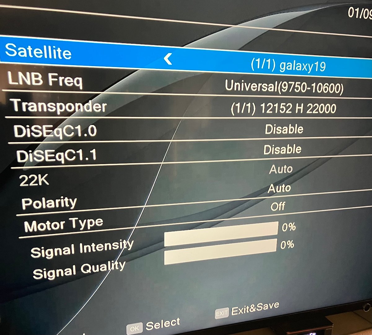

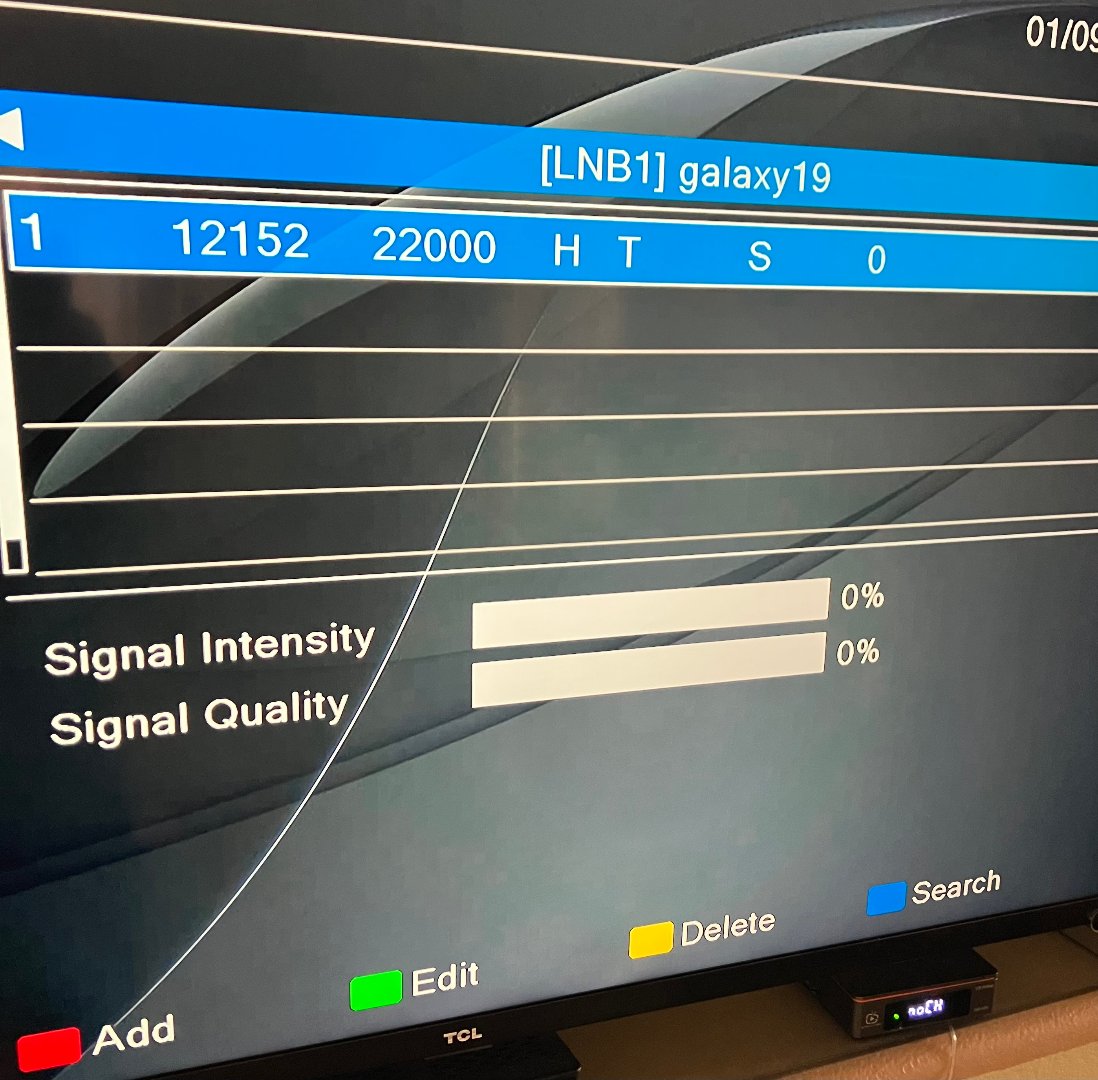

I'm trying to set up a dish for the first time to get channels from galaxy 19. It's an older dish I got from a relative (no branding anywhere) and it has a universal KU-band single LNBF that's new. I used a satellite finder app to position the dish/lnb, and I searched around for what settings to put into the receiver. I originally got around 45%-55% signal intensity, but somewhere in the process of messing around with the settings / dish position, I now consistently get 0%. I tried using the old settings I had before, rotated the lnb the opposite direction just in case, and it's still 0% so I'm not sure what I messed up. I'm using a short run of coax cable with new terminals, so all the connections should be good. Sorry in advance if I'm leaving out a bunch of info. Your patience will be appreciated :)

Try changing the SR for the 12152 transponder to 20000. Or do a blind scan.

You won't receive that transponder until you change the SR to the correct value of 20000. My records show as recent as January that the SR is 20000, not 22000. If you don't know how to do that, then choose a different transponder on 97W Galaxy 19.

Typically I get some signal level on my V9 (IIRC), when I get 0% signal is typically when I'm not "looking" at the correct lnb (wrong 22k or Diseqc switch settings). This doesn't appear to be the case on the settings ZeroSignal has posted a pic of. Occasionally the V9 will "lock up" and not show jack-squat for SL or SQ, rebooting fixes that.
