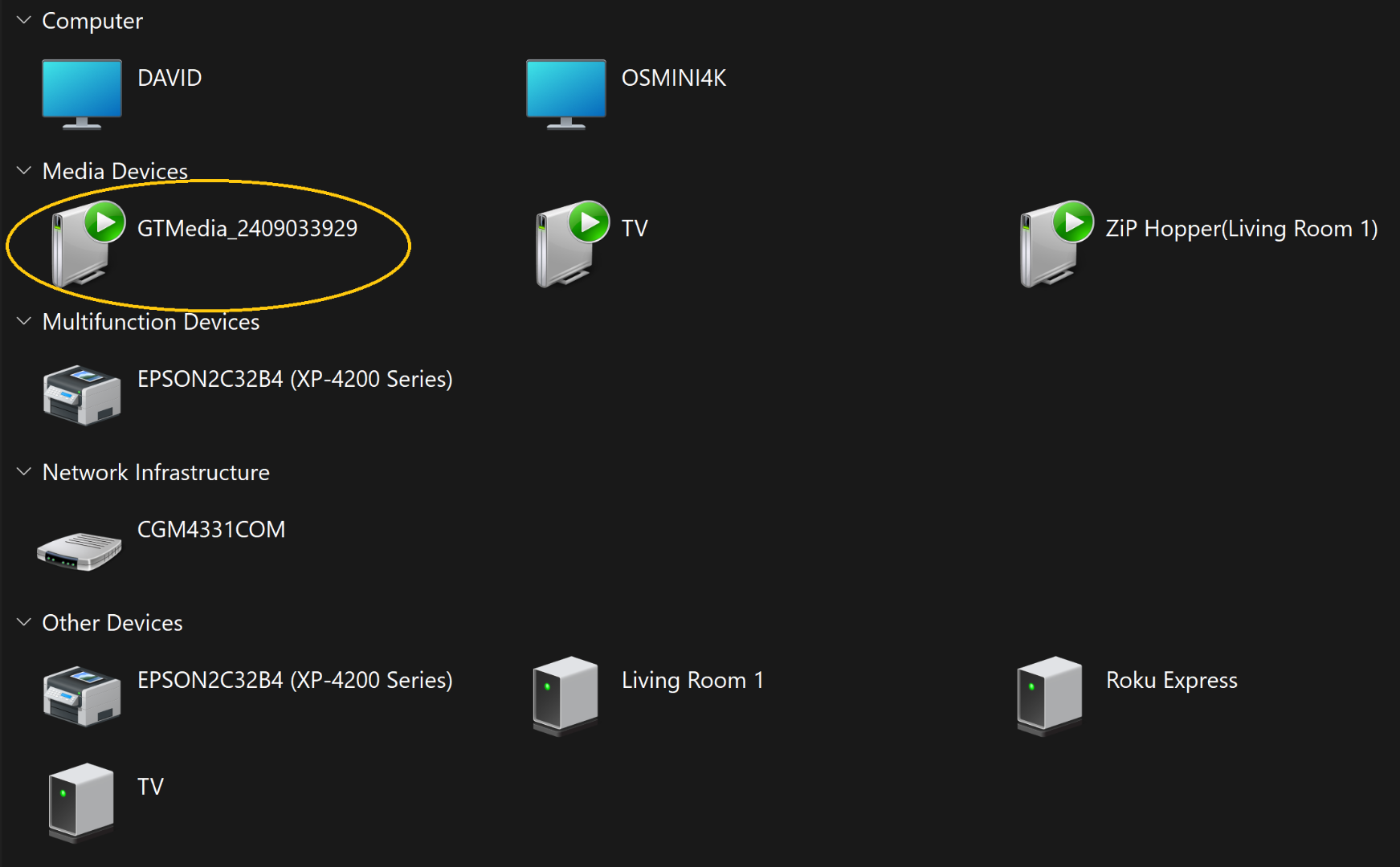

I got nowhere. I opened my home network via Windows 10 for media streaming to all devices. But no progress. At one point, I could see the GT Media from my Windows but I couldn't do anything with it. I like the Edision web interface for remote operation for this reason.
Reactions: comfortably_numb
I see it in my list of devices also, but VLC doesn't detect it.

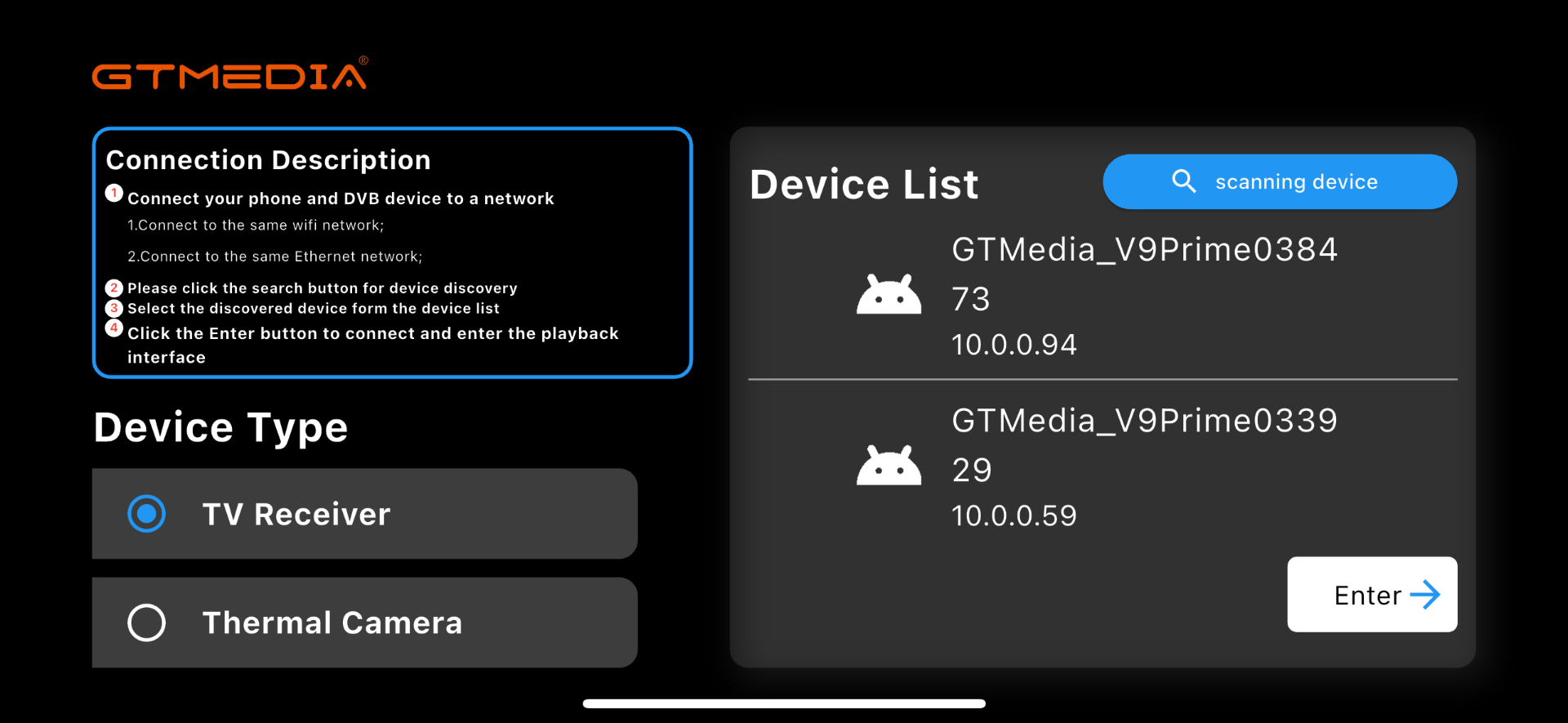

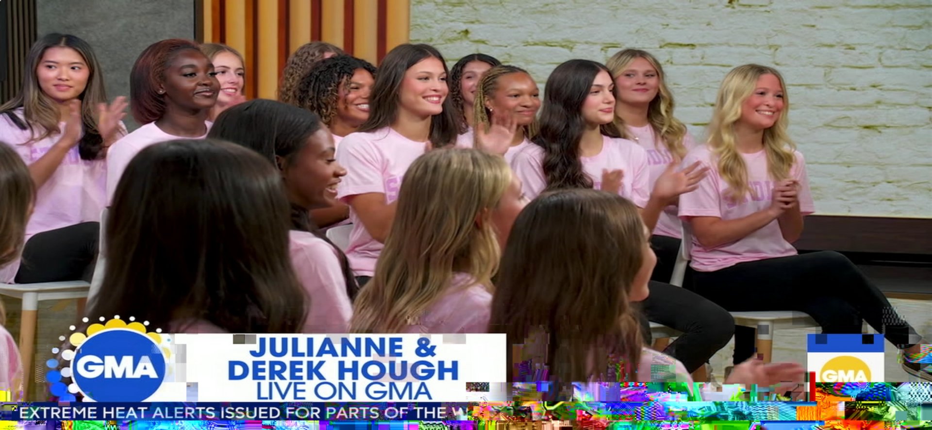

Today I was able to open my V9 Prime receiver on my phone with the GTShare app. It also plays 4:2:2 feeds. The receiver and phone need to be on the same network.
You're using an Apple iOS phone, aren't you? I still can't get GTShare to work with my Android mobile. I can only conclude that GTShare is not compatible with Android. Mine is Android 15 per GTShare specs.
Can anybody get their Android mobile to work with GTShare?
I have using a Samsung galaxy s-24. Glitches though. Also works with iPad.
I have the Samsung Galaxy S21 FE and Galaxy S21 5G. Both operate the same with GTShare in that they don't see any devices on my network. It could still be a configuration issue. Did you do anything special after installing GTShare? For example, change permissions or network configuration?
Interesting how quickly devices go out-of-date. Mine were both introduced to the market in about 2021 and 2022. Yours was introduced in 2024. And then yours was discontinued 6 months ago! I can see keeping devices compatible with them would be difficult with this speed of change.
I just tried an old iPad I have. Updated its software first to iOS 16. It doesn't work with GTShare either. Maybe it's network configuration and not incompatibility...
I had it working yesterday, can't today. Seems to be pretty buggy. I can't navigate the app very well.
