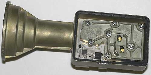

There are two tuning slugs. Simple to tune with a non-metallic flat blade tool and a spectrum analyzer with signal generator. I forget which slugs are for high and low band, but recall that they are labeled.
If you don't have a 12G signal generator, use a known frequency narrow carrier and a SA or calibrated RTL-SDR tuned to the IF. The satellite ID is a good narrow signal (CW) and listed on the operator's bird specifications or licensing agency's grant.
Edit: Found this photo online.

Below from online. It may not be as simple as tuning. Mine is off by precisely 11 MHz as this mentions:
  • Stability: The SNH-031 has a typical LO stability of +/-1 MHz and a maximum drift of +/-3 MHz. If your LNB is off by a significant amount (e.g., 11 MHz), it may indicate a failure or that it is near the end of its life, although, for some, this unit still performs well despite being off-frequency.
I moved the LO 50 MHz! Not because it was broken but because it was made for a nonstandard 950 to 1400 MHz IF. I was changing my system to the more standard 950 to 1450 IF. Technology has changed a lot since then, so you might not have such a large range of adjustment.
Reactions: cyberham
The stability range referred to warm-up and operational drift, i.e. thermal. Over the years, two problems haunted the Invacom LNB(f)s: 1. The feed throat cover quickly failed due to UV. 2. LO drift, which would happen even if it was NOS stored unused in temp/humidity control.
Several times I have re-tuned an Invacom 8+ MHz. Never swept the slugs to check for maximum range or roll-off, but 10 MHz adjustment is very doable.
