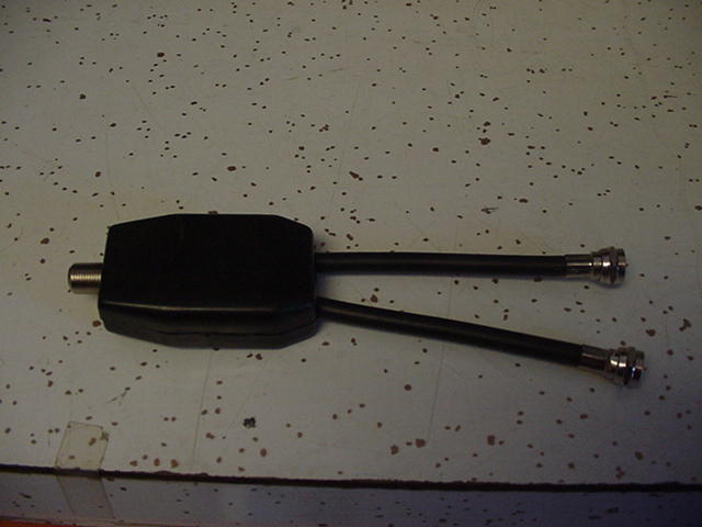

The best way to combine the uhf and vhf outputs of the dual recs, is a 75/75/75 uv band separator. ;)
Reason being the cable "sex" is correct.
Thats a Radio Shack antenna splitter I don't know if they still carry that one but you could get a 300 omh uhf and put an adapter on it to make it 75 omhs.
