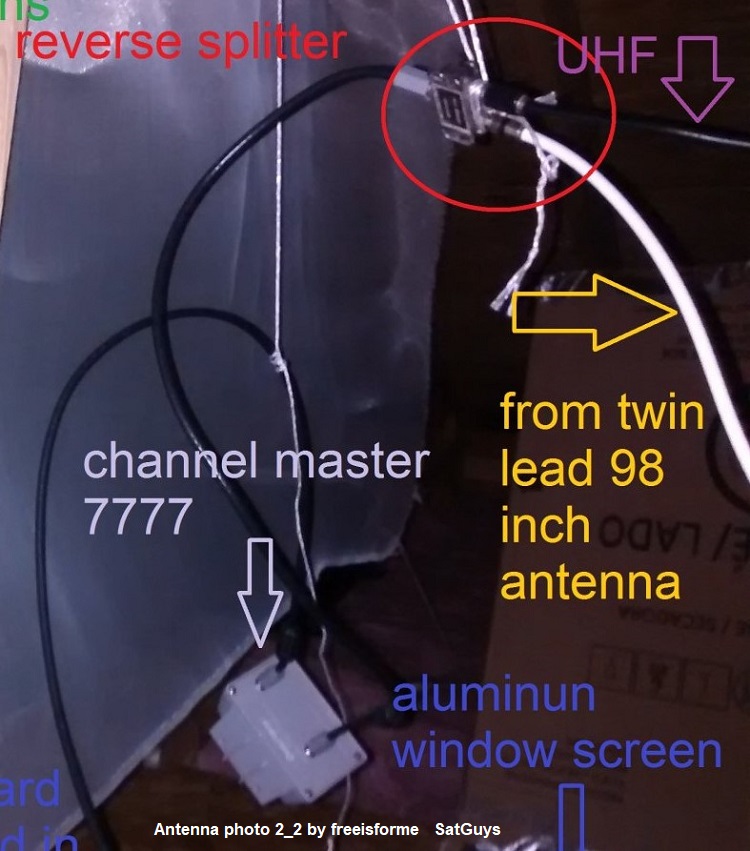

I had two CM 7777 preamps in the attic over heat, " Im guessing" in the past 5 years. Its not the power supply or the inserter. The first CM preamp only works with the strongest UHF signals no VHF. Seconded CM preamp total failure. Reconnected the first preamp using the same power supply and inserter just to have some TV. I had them hanging from a rafter not in the insulation. House has soffit and ridge ventilation, no attic fan. Im thinking about placing the new one in the soffit hoping the, "cooler" air will stop it from over heating. I have orders not to place it in any closet. Looking for other ideas and/or better preamps. Thanks

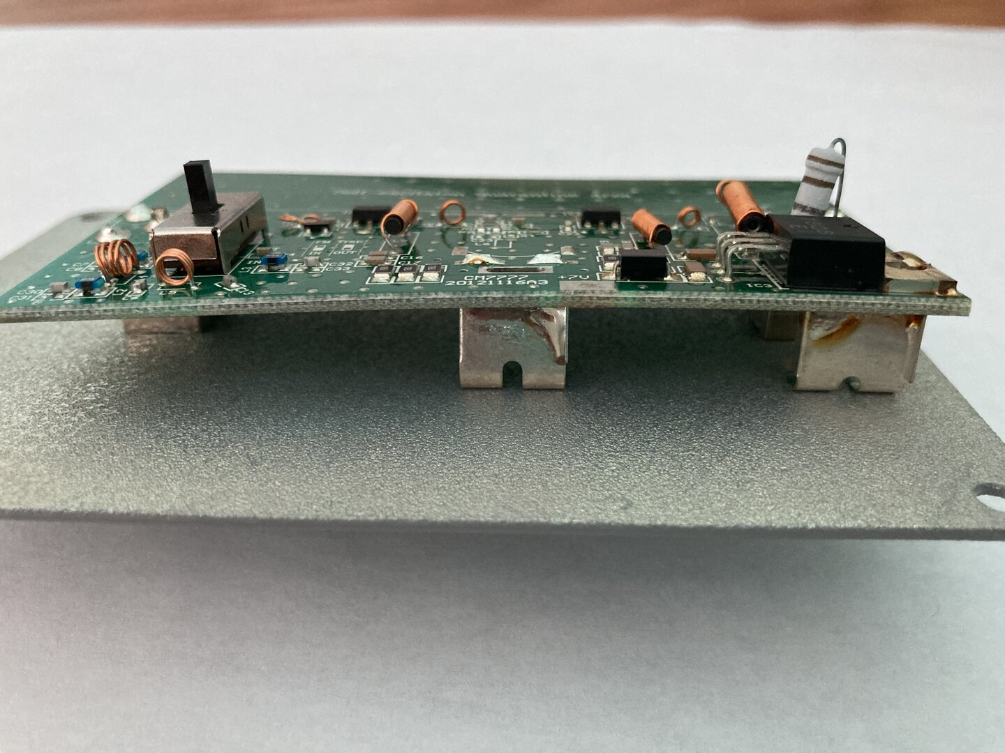

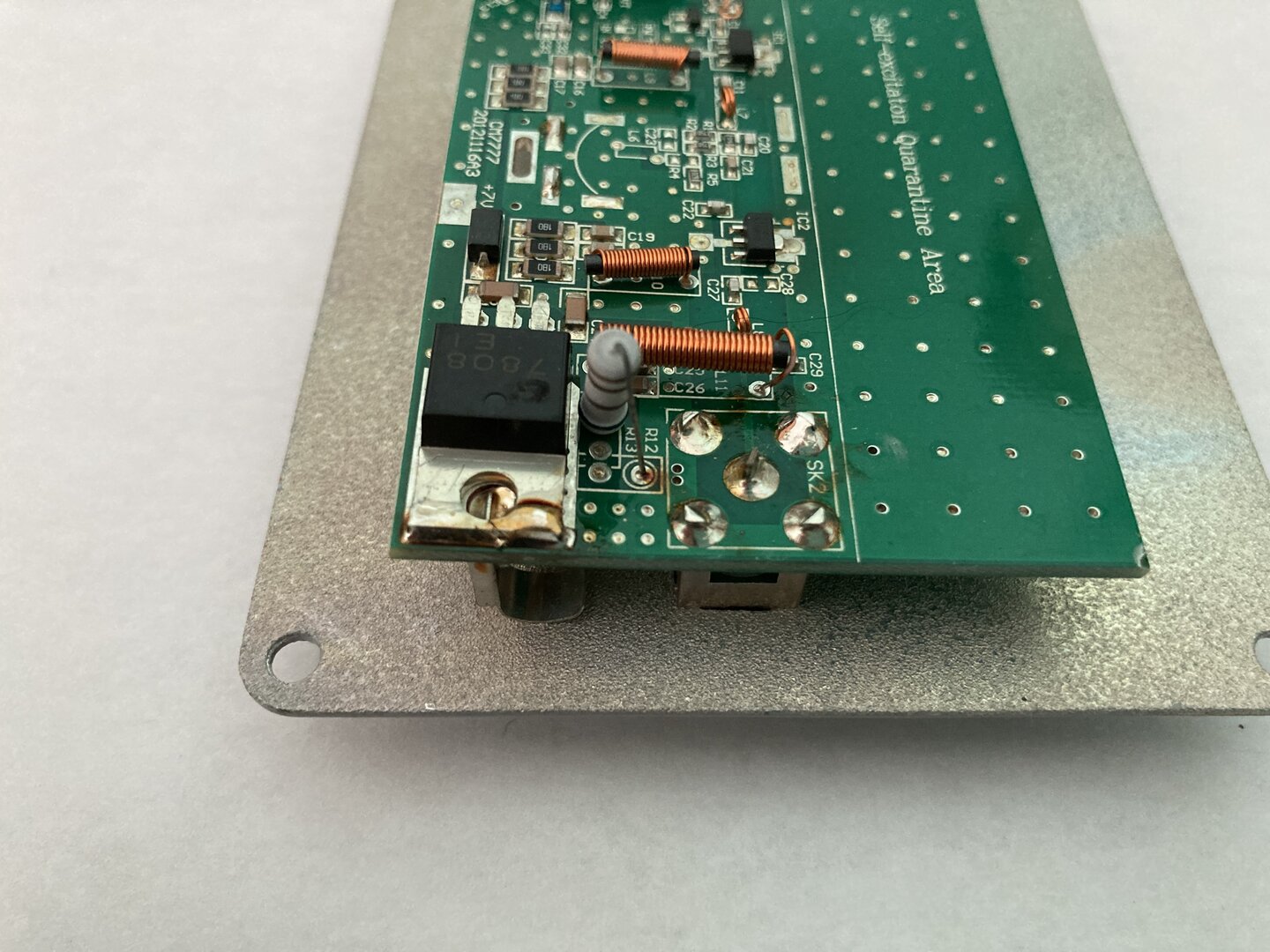

Never mind the last post. Your right. I could have remove the case. The parts are attached to the cover not the case. Im a dumb a@#. Some darken areas area the power input. I wounder if thats where it failed.
Reactions: TheKrell
Your right. I could have remove the case. The parts are attached to the cover not the case...
It does appear to have heat sinks mounted on the back plate. So don't take that off!
If you are looking at the dark spots on those solder bumps in the second (right) image, I don't think that's indicative of a failure.

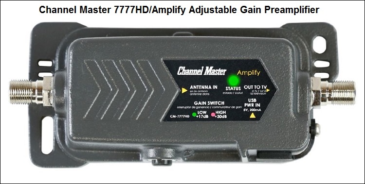

Huh? I've had a CM 7777HD for years with no issues.
Not the same amp. CM caused a lot of trouble when they used the number 7777 for many different amps.
I like the CM7777HD Amplify. It has high and low gain: 30 and 17 dB.

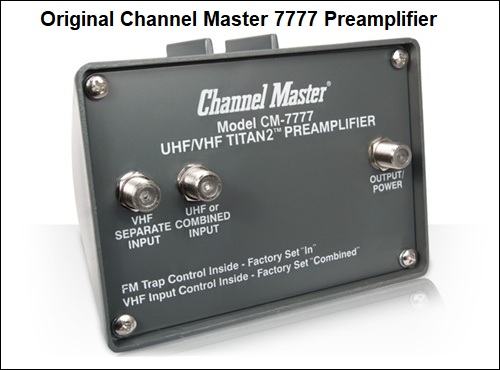

The original 7777 had two antenna inputs; one for VHF and one for UHF. That was my favorite preamp.

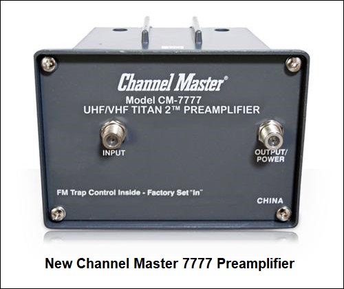

It was replaced by a 7777 that only had one antenna input.
That is the preamp that freeisforme shows in his attic photo. Its gain was stated as 30 dB. CM received many returns. Some users had high signal levels which caused overload. Also it wasn't very reliable; it failed soon. CM changed the design to 24 dB gain, but they didn't change the printed specs.

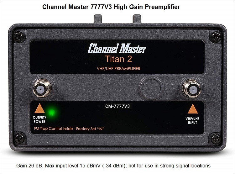

And now there is yet another 7777:
Well here's a thread from way back. I saw that 7808 linear regulator. If it's dropping the 15 volt wall wart pixies down to 8 volts. Well those pixies have to go somewhere. In the form of heat. I'm pretty sure you will get some loss in a long run of coax. But short runs will definitely get almost all of the juice (and amperage) to the amp.
See where the guy dropped it to 12V? I'll bet you the regulator was cooler too.
If it were me. On my 7777 I would slap a lab supply on it and drop the voltage to where I start losing dB. But I bet if I keep it a touch above 8 volts AT the regulator.....it's gonna' work just fine. The data sheet mentions thermal protection as well as short circuit protection. That one looks kind of chinesium. If you touched it with 15 v running to the amp. Would you blister your finger? How hot is hot? Like, you power it on and it works for a few minutes and then craps out hot?
