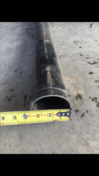

This guy up the street from me has 10' 6" of this size pipe. Is this pipe to thin for my 10' unimesh?
Thanks in advance
-b
The guy just emailed me back he says it's It's schedule 10 sprinkler pipe & probably 1/8 thick. So i guess that's not going to work... darn

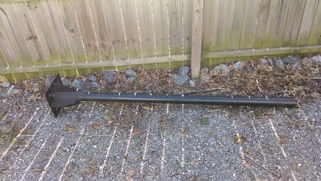

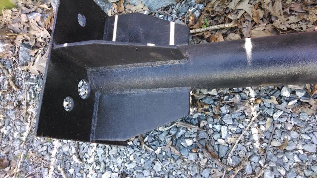

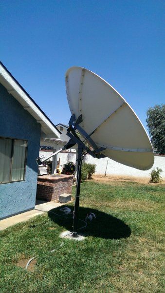

A local shop supplied all the metals and made this for me for $75:

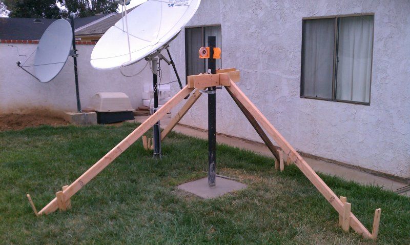

I had to use a 10' 3.5' od pipe for my Laux Beta-9, here are some pictures of the pipe install on the ground.
Regards.
Tunder
