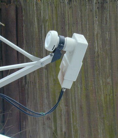

pop the cover off a DN or DTV single an little exact o carving, a little silicone sealant and...Jack's your Uncle.
What is the silicone sealant for? Seems like with those big drainage holes at bottom and sides that are big enough for a grasshopper to climb through silicone sealant wouldn't do much. However I haven't taken the cover off to see exactly how it's put together so I may be missing something.
Forgot to Add pic to my above post.................
