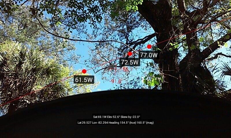

Yep, we did that for an NHL hockey game one time through a tiny hole in the branches. We've been on a number of sites where neighbors couldn't believe we were really getting satellite service. The photo below is from one park where a neighbor swore there was no possible way it could be working until I showed him our TV picture. We did get some wind caused interference once in awhile. Between using the eastern arc that many RV'ers are not equipped for or even know about, and the offset dish actual sight line compared to the apparent sight line that many don't seem to understand, it's not surprising they question us sometimes I guess.

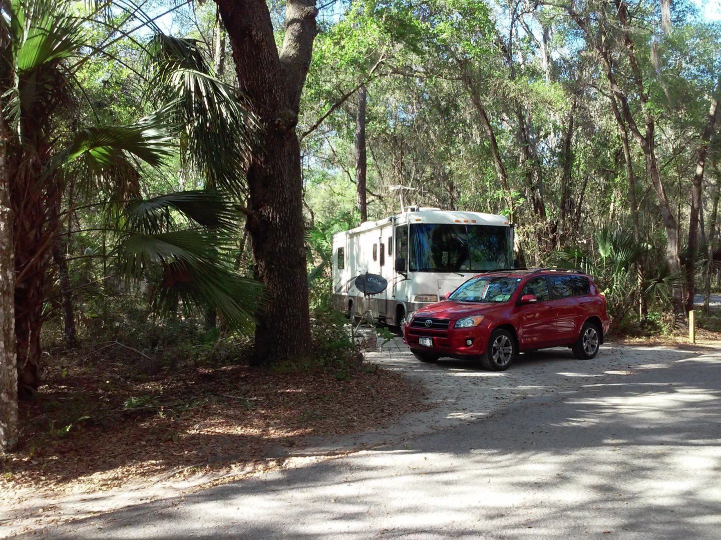

Yep, I once split a tree that was a little way off, hitting 61.5 on one side of it and 72.7 on the other. This photo shows how the dish from the first picture looked to the neighbors. :)

Those leaves are sparse enough that enough signal gets through to let you watch TV, I'd assume
Yes, with just a little pixelization when the wind blew. Signal levels kept varying between yellow and green. Sometimes it switched from HD on 61.5 to SD on 77. We were only on that site for 3 nights, so it wasn't much of a problem.
