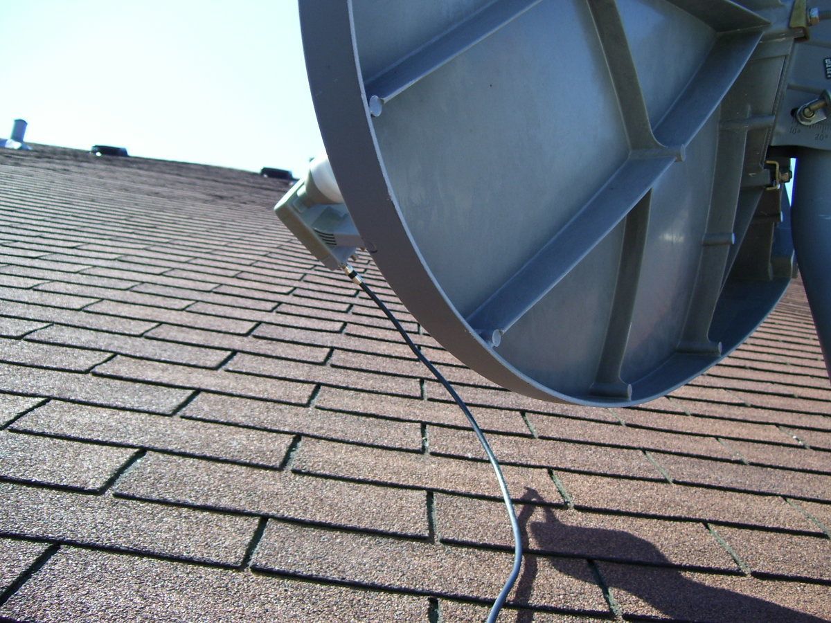

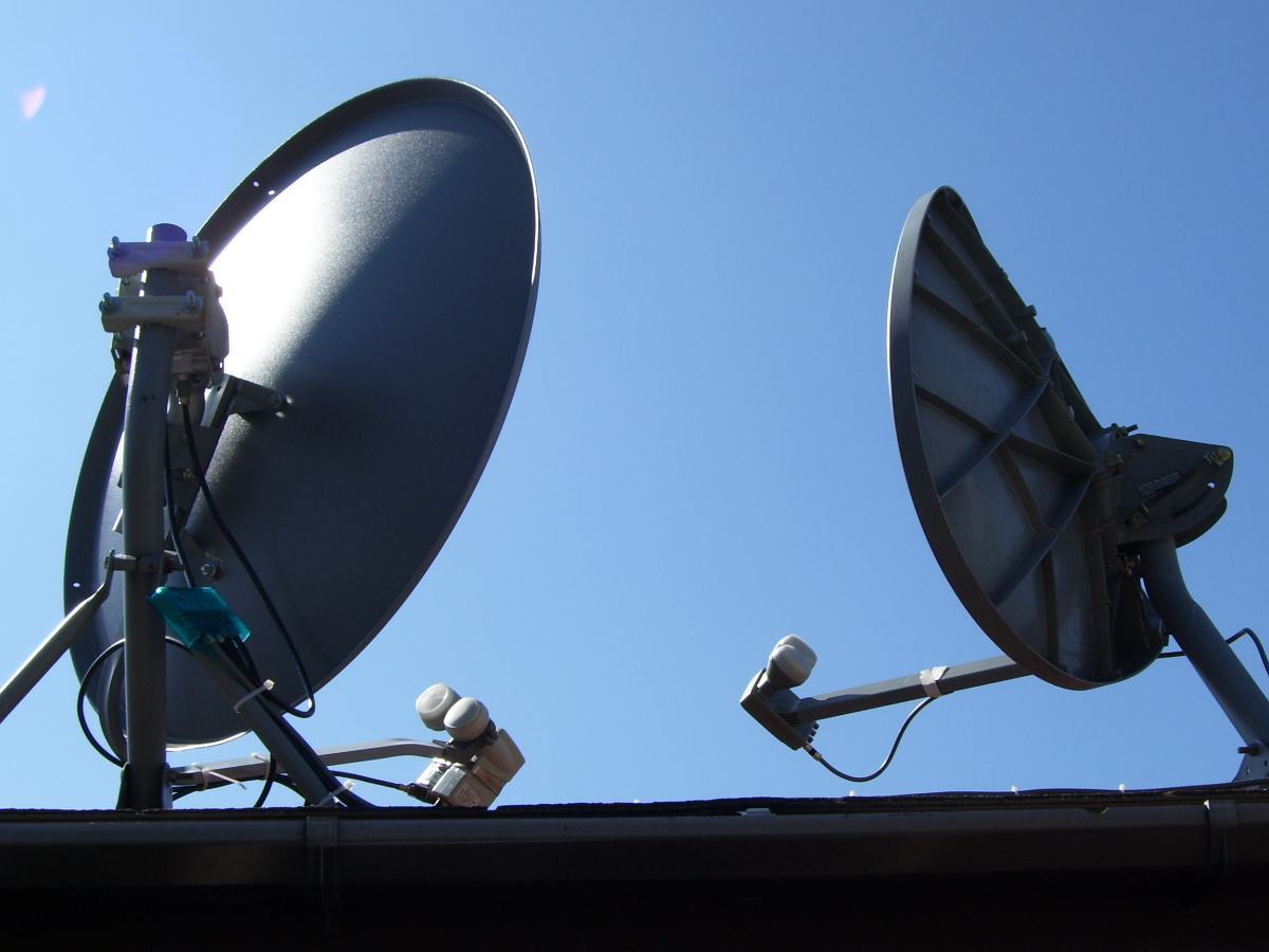

I use to get 30W with a 8 1/2 elevation...but then trees got in the way
(dish on the right)

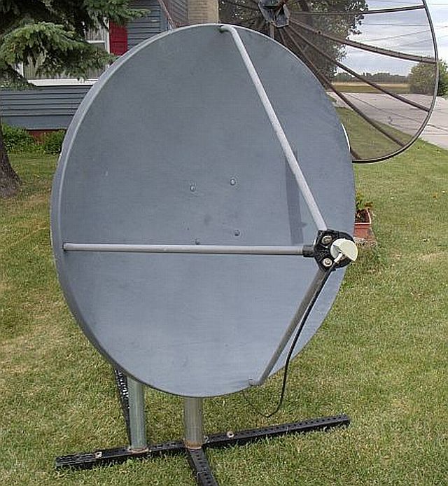

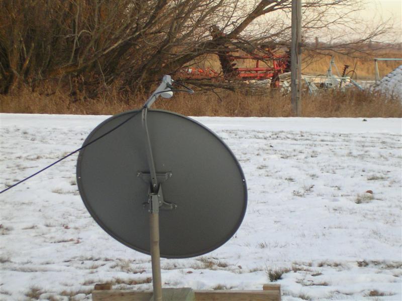

I have no trouble with 6 deg elevation to get 30W. Had to do some looking before I decided on a place to set the dish though... away from ground clutter etc, and within reach of my feedline! I had to mount the dish and LNBF arm upside down in order to get the elevation low enough on a 33" digiwave. Looks really strange sitting in the middle of the lawn... -C.PICT0008 (Medium).JPGPICT0009 (Medium).JPG
Try inverting the dish to mount upside down (LNBF arm on top). The face of the dish would then be pointed upward at 33 degrees. This will help minimize undesirable ground noise.

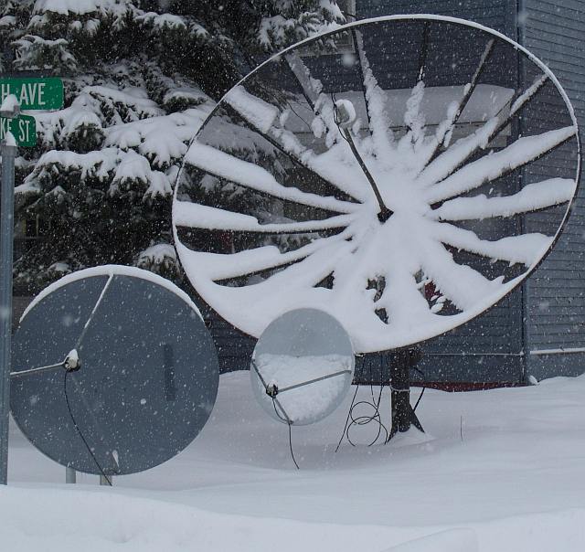

I have 30W at 6° elevation. CM mounted sideways.
