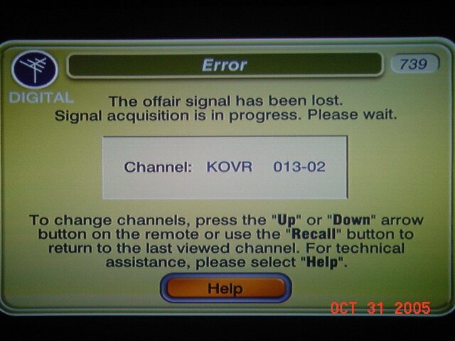

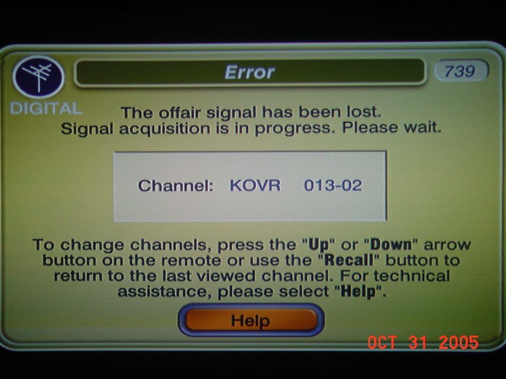

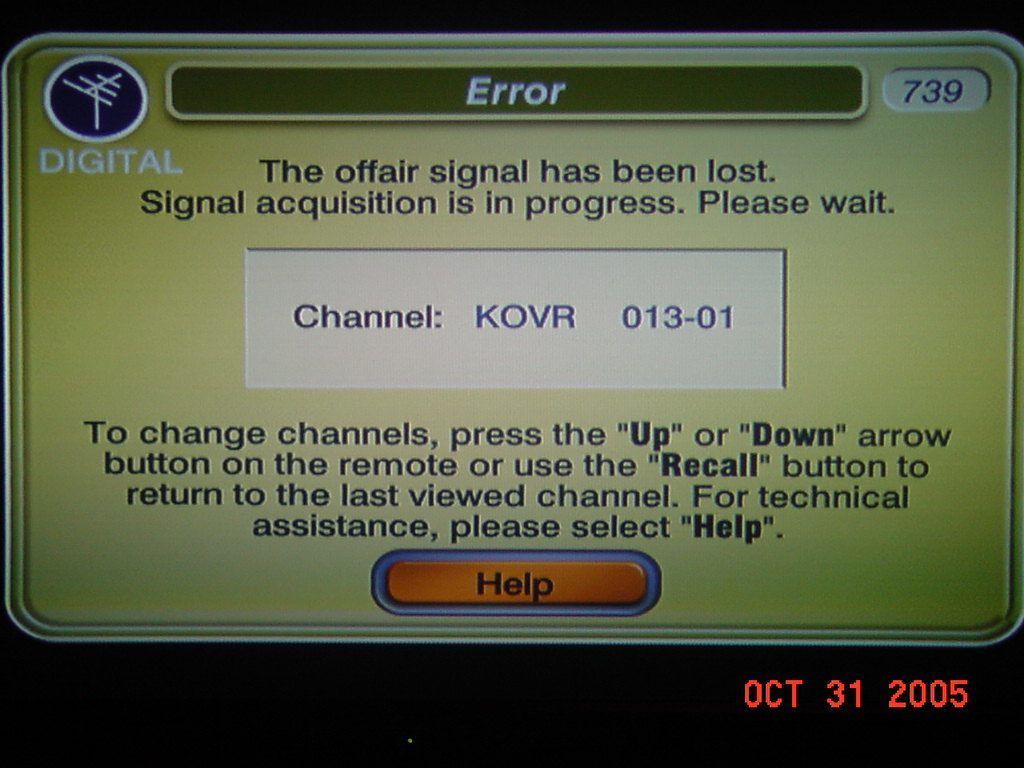

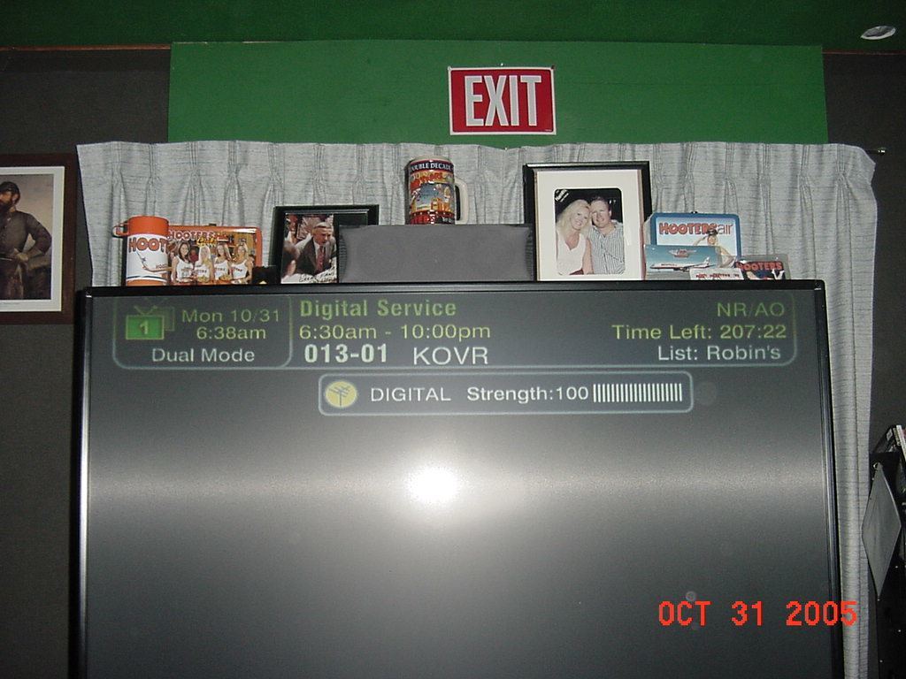

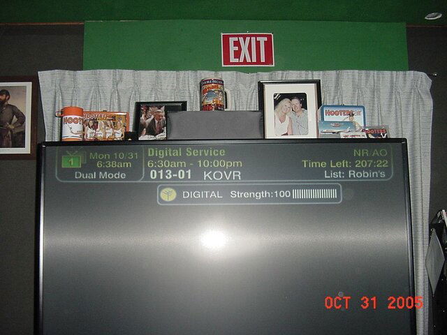

I have a question. I have a 942 and a 322. Yesterday (10/30) and today when I try to watch channel 13-01 or 13-02 on my 942 I get the screens stating the signal has been lost. Yet it shows 100% reception. These are being received by an OTA. I receive 10-01 and other OTA channels just fine on the same unit. I do get channel 13 on my 322 (it's just 13-00) I've included pictures of the screens.

Remove all the local channels from your 942 and then once done rescan them, the missing channel should come back. :)
You also might have a multipath problem. Is your antenna in the attic? Trees in the path of the antenna?
I had a similar OTA issue recently... and thought the same thing you did.. that the signal strength was fine... However my antenna bolt had broken and what was happening was the antenna was moving in the wind. The signal would drop to 0 and before the 942 could recover the alert came up and then the picture came back. I just happened to see the 0 one time and started poking around.
Check your antenna aiming.. it could be it just far enough off.. that something blowing in between it and the towers is causing the problem.. if it's an outdoor antenna then make sure it hasn't moved on the pole.

I too am noticing the same problem as you are, Tobar. Unfortunately, with the horrible 811, I don't get the loss of signal screen. I have to reset the receiver or unplug the antenna so I can change channels.
I do not have any problems with any other OTA channels. It seems to be a problem with KOVR themselves. The station has had more difficulties than any other station in the area. I have an e-mail into Mr. Olson the technical director. He is usually very helpful. He helped me get my waiver so I could get CBS HD East Coast.
