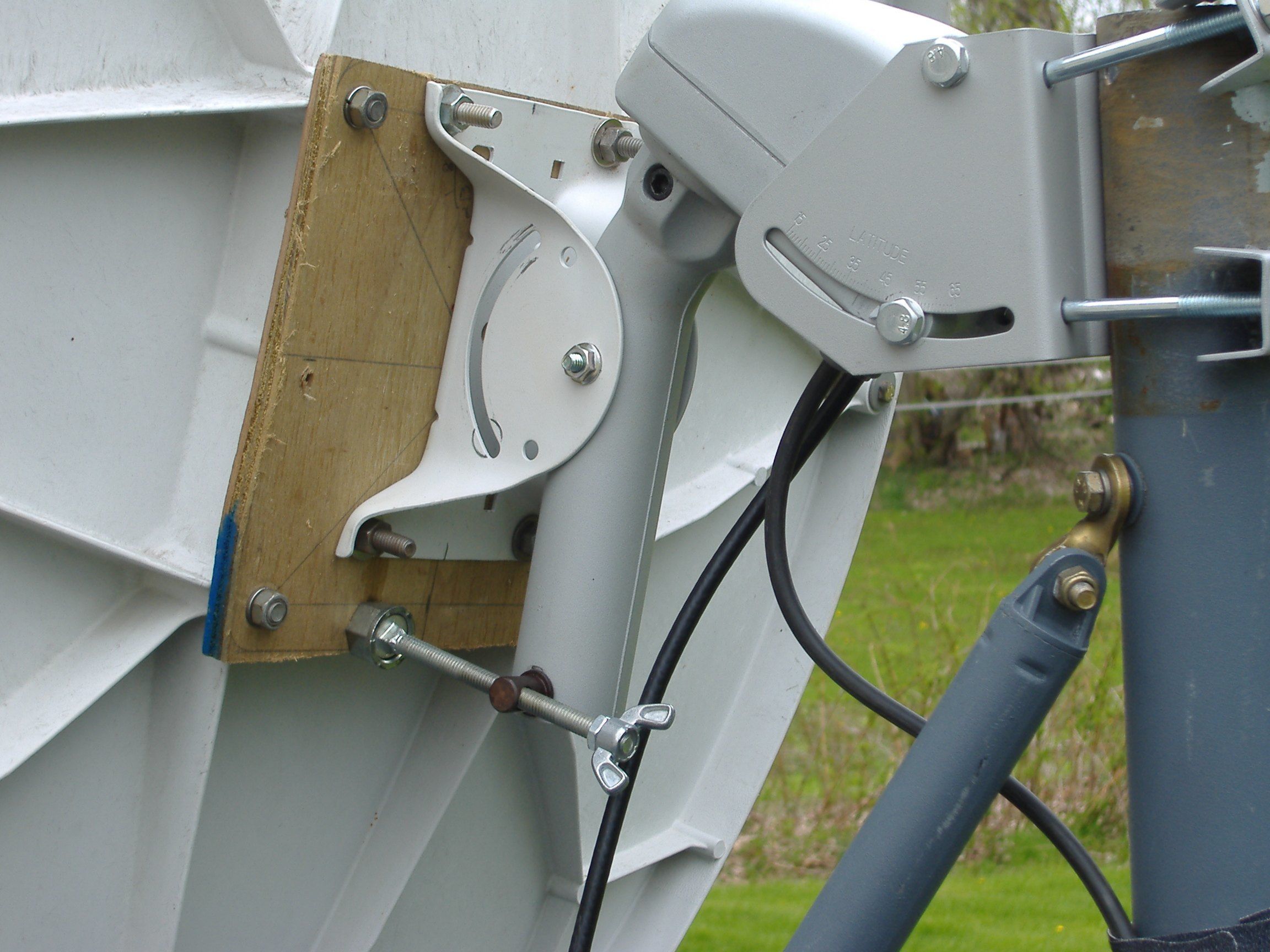

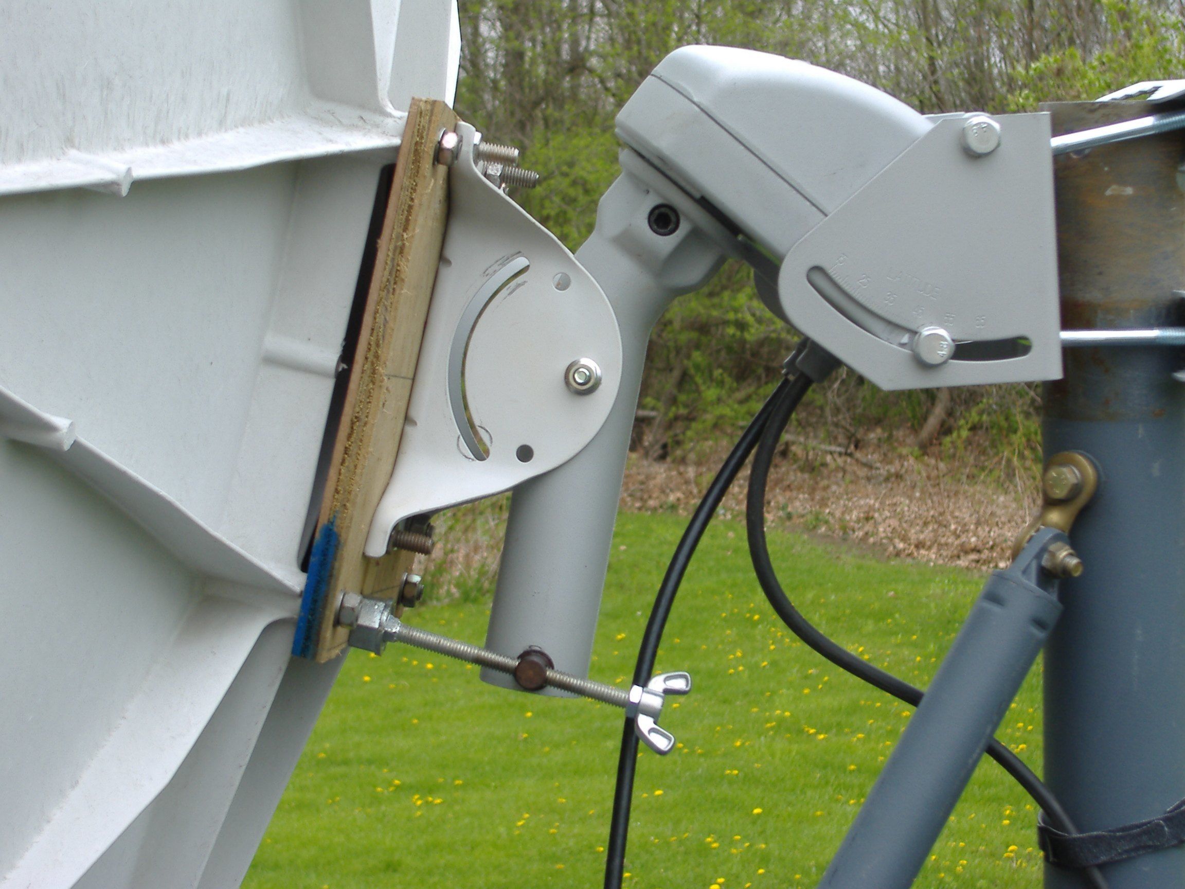

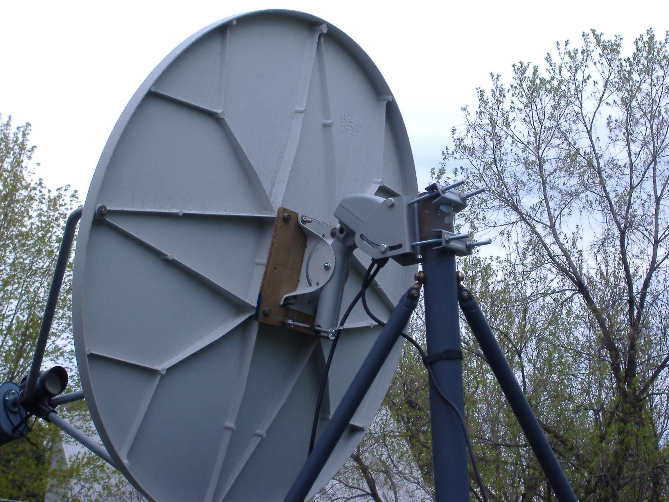

Glater I ran into the same thing with the DG380 motor I bought. Nothing I tried, using the 84e mount, would tighten it up enough to make it stay in one place on the tube. If I moved it west awhile and back, it would lose tracking , due to wiggling on the tube. This motor comes with a big tube, but not big enough to hold onto the 84'e inverted mount. Finally got smart and made my own mount, but decided to put the 84e back together and use a round dish ( .90 primestar) . If you can't find the thread where I did it back about 2months ago, let me know and I'll try to post the pictures again. Mine's held strong with daily use, the way I fashioned it, and I think it'd prob hold a 2m dish, if I had one, hehe.

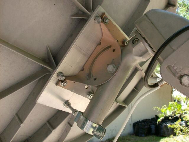

Here is what I did with my 90CM ChannelMaster, which has a very similar mount as your 84E. I used the 42mm tube. I had tried to mount to the motor with the original mount upside down on a 50mm tube, but I wasn't up to speed yet on getting motorized and the weather just got to cold last fall. Got this hooked up a few weeks back and it works GREAT!

That's agood job Larobpra , would've done that too but I was afraid of drilling a hole through the tube on my new motor.
Turbosat, I found your thread. Your setup looks workable for the 84e also. I know that you set the motor angle for your latitude. Was it much trouble to get the dish elevation set with the clamps to track the arc? Nice setup!
Larobpra, that's a cool setup up too. I was hoping not to do too much modification, I'm not to good at improvising. But you guys make it look easy. The threaded rod for the dish elevation looks good.
With the 84e mount inverted, there's plenty of adjustment left for dish elevation. Was hoping to be able to get the slop out using what I have, but might end up trying to build something like you guys have. With all the reading I've done about motorized primestars, I hadn't seen either of your setups. I'll save the pictures from both setups. Thanks!
