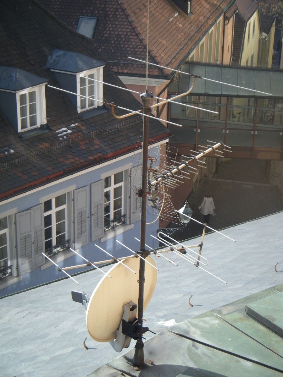

I knew I'd get called out about that. I just wanted to share my vacation photos with people that would appreciate them more than my wife does.
Yea, I was gonna let it slide, but I did notice several things:
- tiny dish
- not motorized
- dish very close to the base of the pole (which looks like a vent pipe)
- OTA antenna are small, and waving on that pole won't bother the dish
- no way that picture was taken in the USA... imho...
Loved your photo! - :up
Got a great laugh when I saw it! :D
