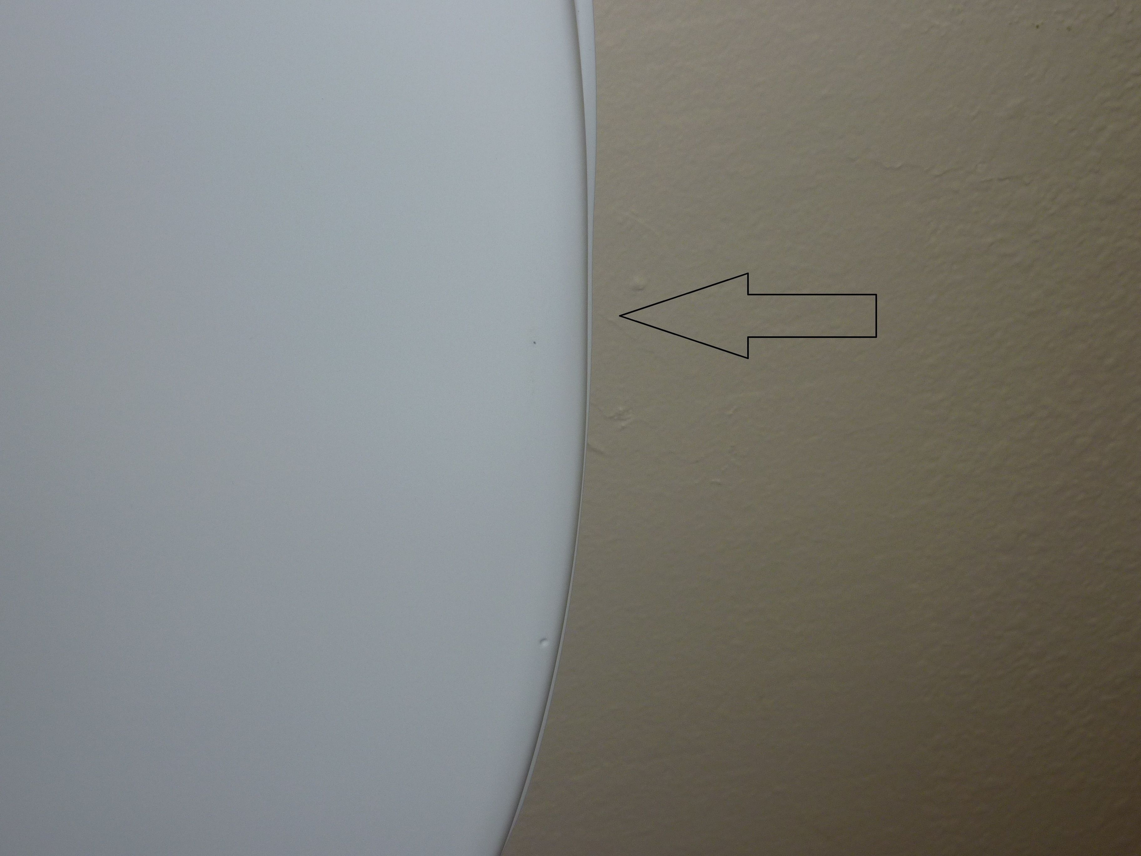

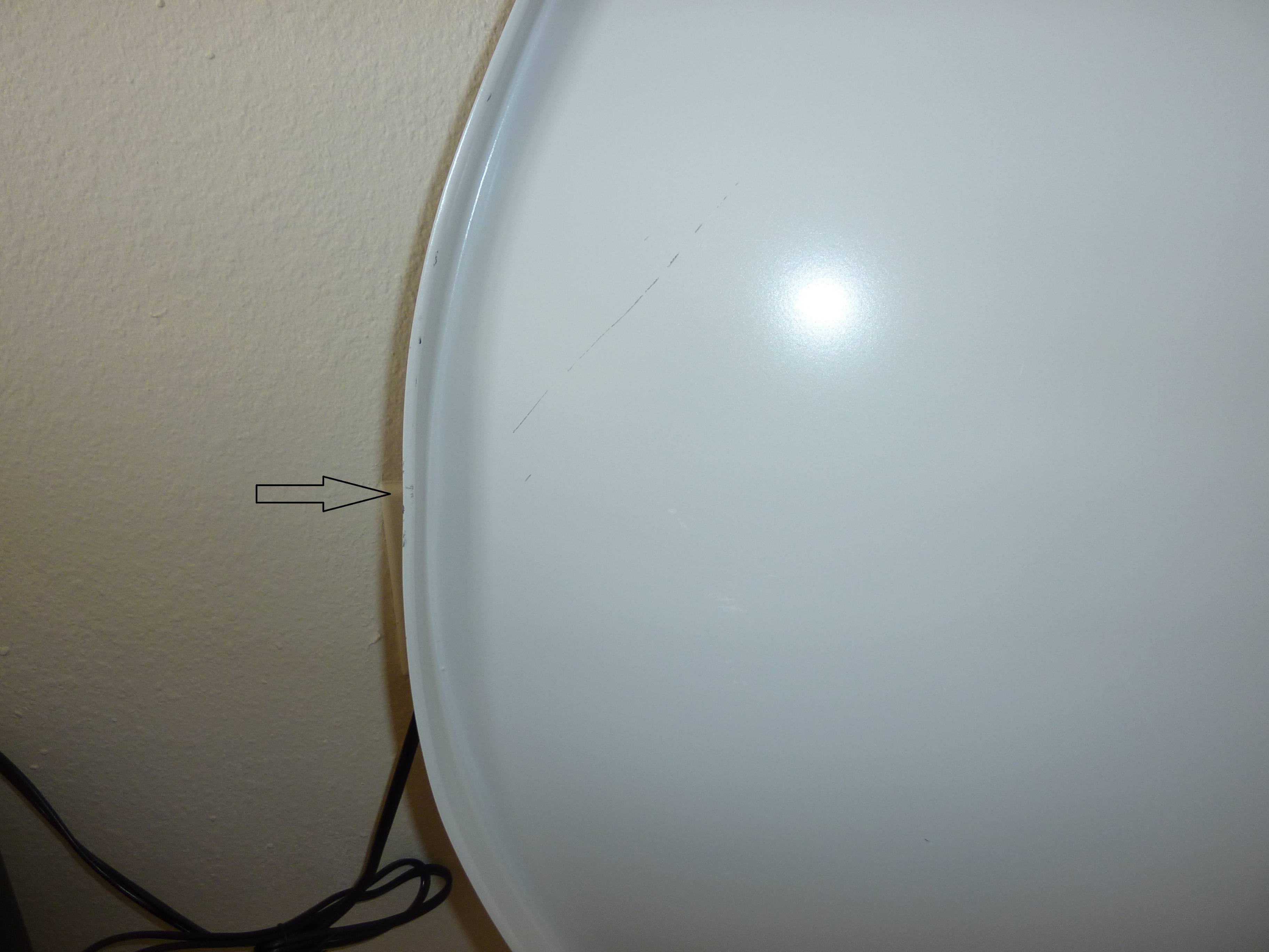

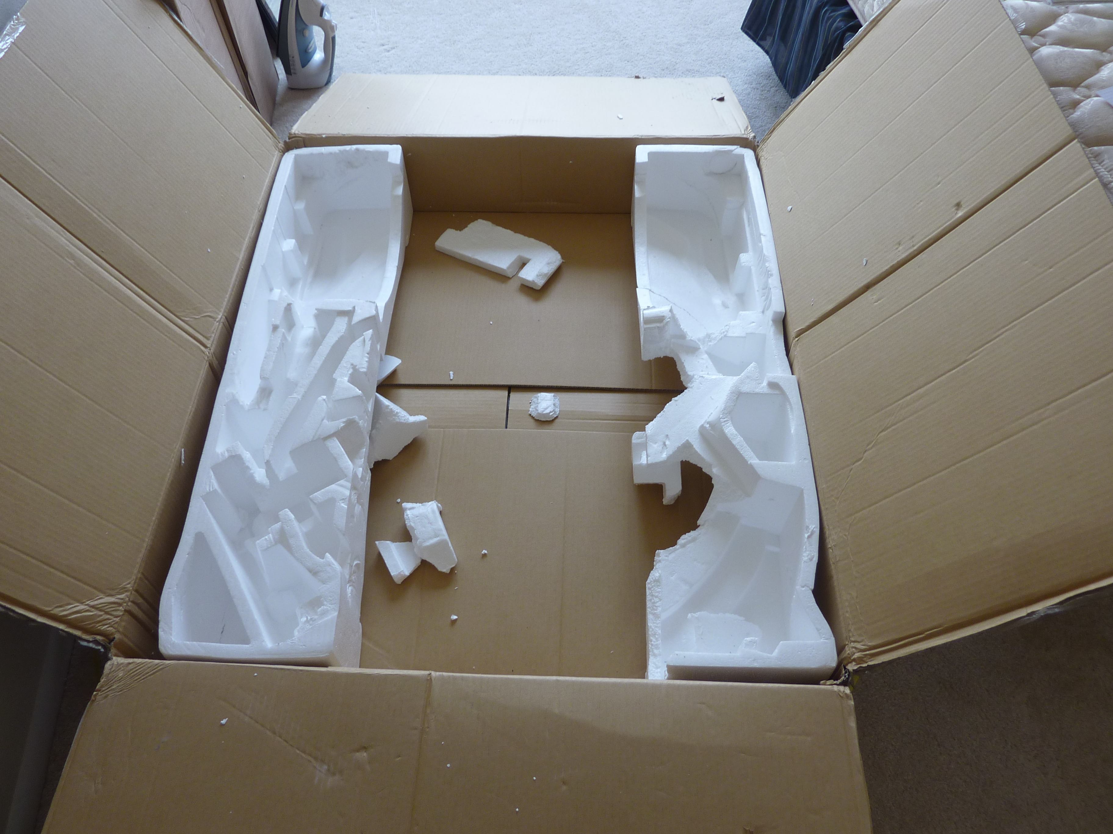

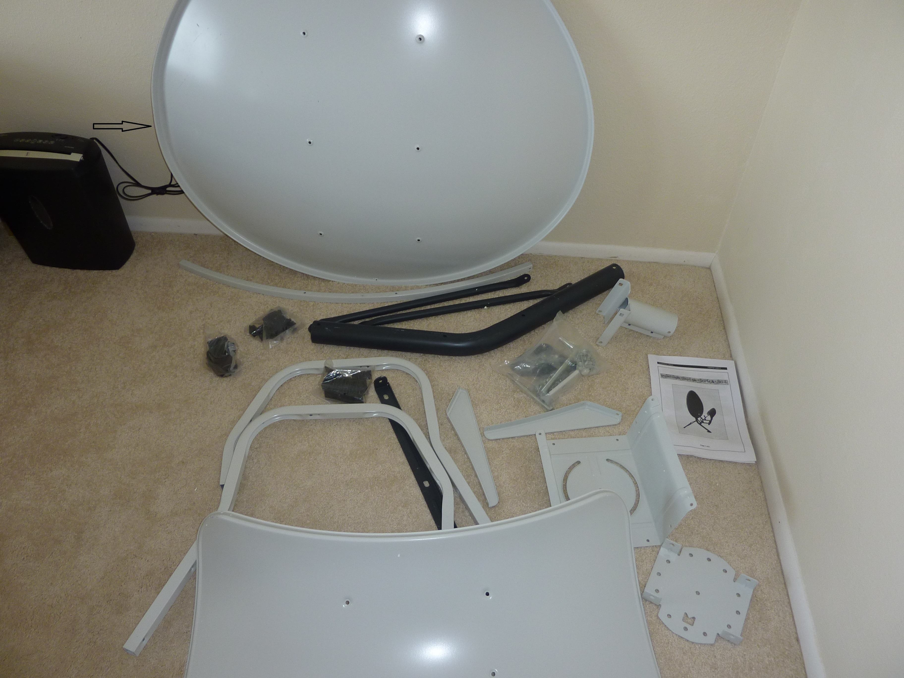

I got my T90 yesterday, the box looked damaged, there is a dent on the satellite dish that makes me worried, I tried to align it by pulling it back using my hand, but still noticeable. please tell me if that would affect the signal.
there were accessories outside the box (kept kind of in between by the tape seal off) please tell me if I got everything
Thx

it is fine....it is more important for the dish to be "square".....tape a piece of string accross the dish at each side....then tape a second piece of string from top to bottom.....the two strings should be touching in the middle....if they are not touching, this means the dish is "warped" or "out of round".....this can cause problems....but small dents will not result in signal loss.....
