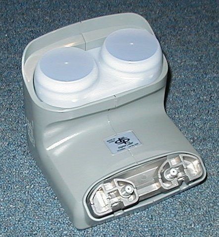

Thanks for the replies. Here is the needed additional information:
I have Dish dual LNB. Since I am not able to access it right now, I am attaching a picture of it.
Let me know if there is more information need to determine which switch I will need.

Actually you have a DishPro TWIN LNB, not a Dual. No "SW"-type switches for you, mate - they don't work with DishPro.
As for Quad vs. Switch. Actually the Quad is just a Twin with a 2x4 switch built-in instead of a 2x2 switch.
So, for no more than 2 birds and 4 tuners, a Quad is A-OK. Once you cross either of those lines, you need external switch(es).
If you're not going to need a 3rd bird, go ahead and get a Quad.
If you grow beyond 4 tuners, you'll need an external switch. A DP34 would be typical, and give you up to 6 tuners (2 straight to the Quad, 4 off the switch). Maybe a DP+44 would be right - if you end up with any 2-tuner boxes you can save ports and feed cables. Don't worry about it for now.
