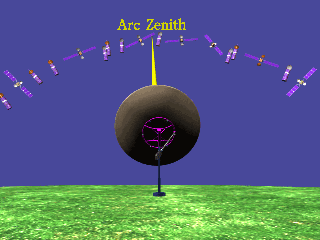

When you do add the motor use.......
Motor elevation = 64º
Dish on motor elevation = 26º
The dish elevation may need changed to peak in the signal but the motor elevation should never be changed!
Thank You PSB I'll try it like that. one last question can i move the motor angle in case that i find the AMC5 in a lower angle?
No never! As long as you are sure the mast/pole is level all round all you will need to move is the dish elevation slightly up or down to peak in the signal.
If you change the motor elevation you will not track the satellites (Clarke Belt) accurately!
