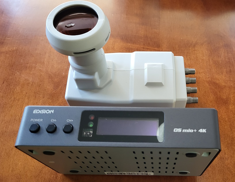

I always wanted an Invacom QPH-031 LNB. In the old days, there was a whole sub-hobby of looking for scrambled channels that were temporarily in-the-clear. That's pretty much in the past. That's when the Invacom shone since it could receive linear and circular Ku transponders all in one LNB. And, I understand, even simultaneously receive them.
Since the price of the QPH-031 has come way down and, just for nostalgic reasons, I got one and it arrived today. The sucker is built like a tank! It's big. It's heavy. It looks and feels like it will last. Check out the attached photo which shows its size in relation to an Edision receiver. When I installed the Invacom and tried it, I thought there would be a compromise in the linear signals because it's a combo LNB and, well, it's old technology. Not so at all!
I'm quite familiar with what my GeosatPro SL1PLL standard and Avenger PLL universal LNBs can deliver. The Invacom is as good. And without playing around with sidecar additional LNBs, I can now scan in the circular transponders as well....just in case there are some ITC or maybe I want to watch a few Mexican channels.
So it's a keeper. Just having a product that performs elegantly is why I will leave it in place on my dish.

Does the weight of it affect the hanging angle of the dish arm? You might want to consider adding some bracing side arms a little higher up.

I was afraid it might even pull down a touch on the dish making it necessary to adjust dish elevation. It didn't. I just replaced the previous LNB with the Invacom and I didn't even have to tweak the motor. The LNB arm is quite strong. My other dish still in storage has side support arms. I may eventually substitute that dish for this one and keep this dish for fixed use only.
There are advantages of this "floating" LNB arm. If necessary, you can tweak the LNB position when installing a new LNB with a little armstrong tuning of the arm.

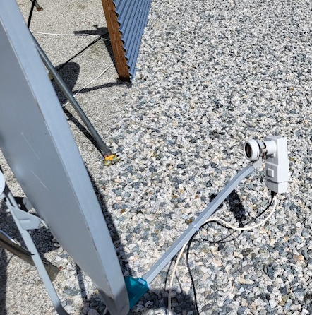

My side arms are in storage. So after experimenting with my C-band LNBF and then reinstalling the QPH-031, I added supports using two light ropes from the LNB arm up to pre-drilled holes on the top of each side of the dish. When I snugged up the ropes, I gained over a dB. This will do for now.
