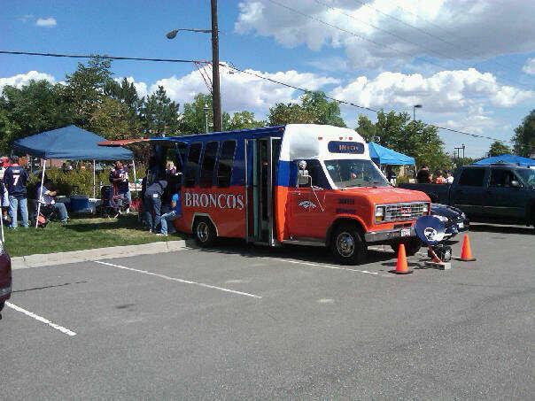

Also another tip instead of a tripod a cinderblock works well to takes up less space and easier to transport. I am assuming you will be in a parkinglot so the height should not be a issue. Take a look at our setup.
