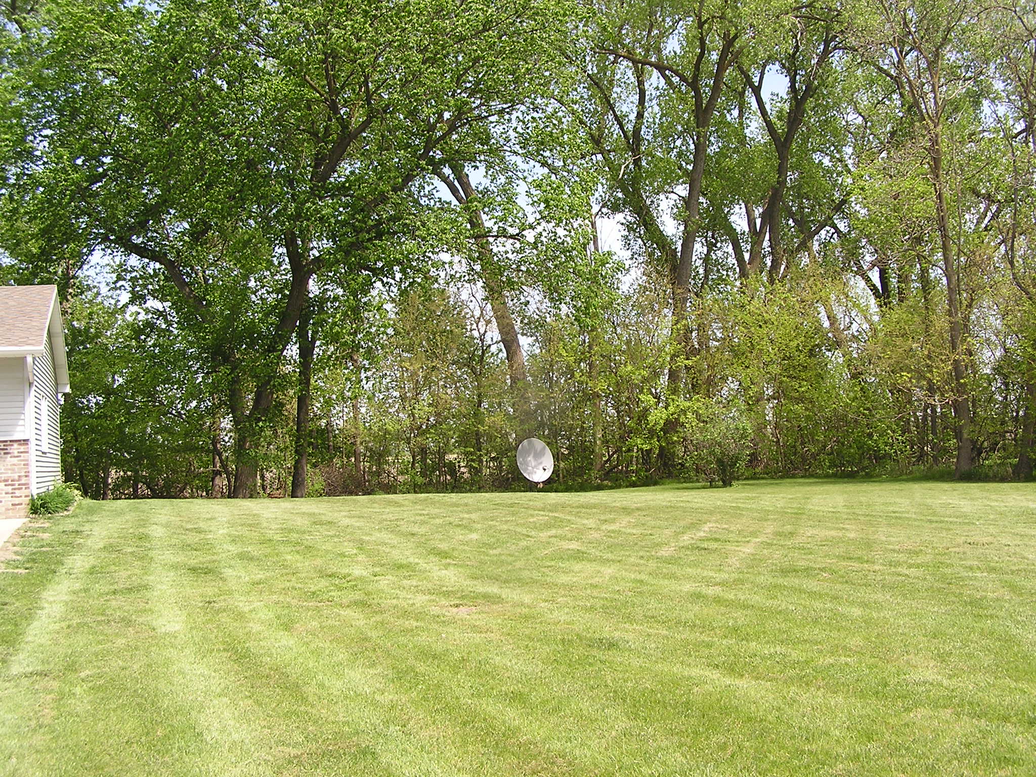

For those of you who do not like the satellite lists that come with the North American files for the Openbox S9 HD receiver, I thought I would post a few lists that I was tinkering with. I can not find the best list I created as it is lost among the many file folders on my laptop. Started a second good list for my minibud when I moved it to the back yard, but doesn't have a full scan of channels as the dish is not truly aligned to the arc, it's only a temporay setup for testing a spot in the yard- getting ready for the 6 foot solid panel dish install for cband.
I received my 6 foot dish from Galaxy Marketing yesterday along with the Vbox mover, thanks to Magic Static I received the actuator via UPS this morning. But still have a few branches to trim from an elm tree before I start installing the new dish. I plan on placing the dish about 30 feet behind the temp minibud so it is in the tree line and I wont have to mow around it. The elm tree above the offset 1.2 meter dish in the photo has about 6 small branches that will impead reception of many sats, after the pruning I will have clear view of the arc from 50W through 139W.

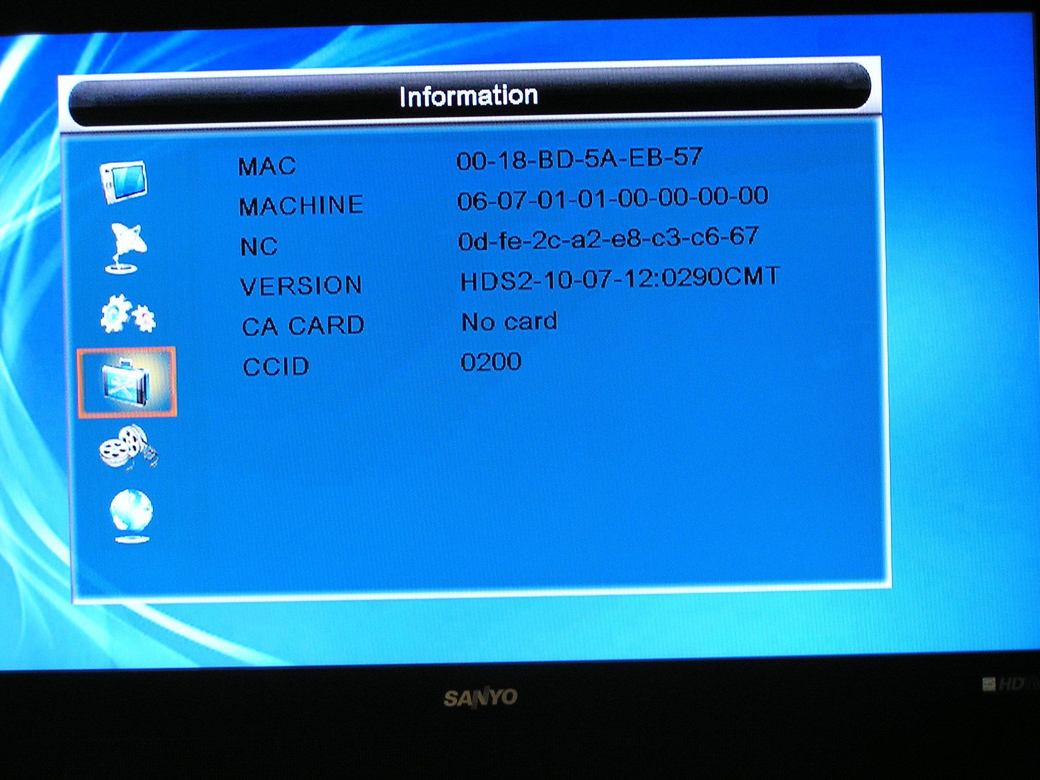

Attached is a photo of my current dish setup and two satellite lists, one that I currently use, and one that has additional satellites and transponders for. Keep in mind you can only load a total of 63 satellites to the Openbox, any more than that and it does some really weird things. I am also attaching two screen shots that Openbox users might find informative. If you go to menu- then tools- then click on information and enter 77777 or for some units 8888, it will show your chip set ID, this is good checking for clone status. However it would seem that this information only appears after you loaded new firmware that might brick a clone unit, for example in the next photo you will notice the CCID listed as 0200 on one of my Openbox receivers, if I load new firmware it will change to 0200:XXXX. The X's will be the chip set ID, there is a list of valid chip sets posted at another forum, can't recall them off the top of my head.

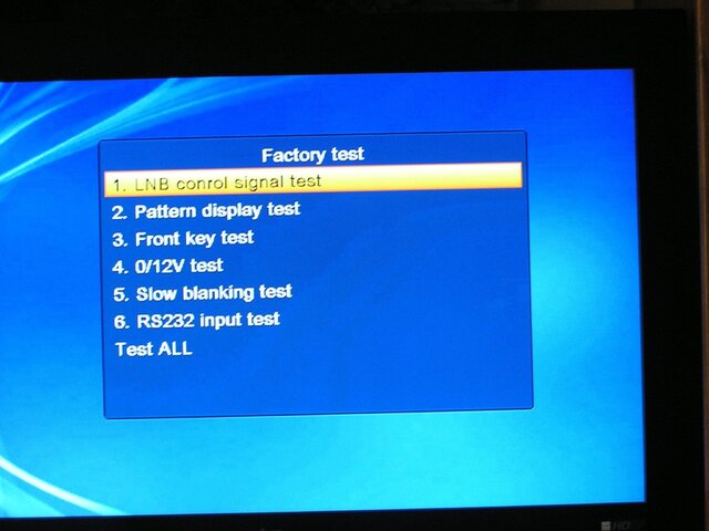

Another hidden menu that you may find usefull, go to menu, then tools- then click on information and enter 11111 on your remote, this brings you to the factory test menu. As shown in this photo.

I haven't try the new firmware and will not even try it. When I hit the 77777 I get CCID 0107
The only firmware I can imagine trying for upgrade is the green screen fix if your box doesn't already have it. From what I read this fix also slows down the blind scan so there is a trade off. For me I am running with the HDMI cable so it wouldn't do me any good to upgrade to the newer firmware. I do however have another Openbox with the green screen fix, and yes the blind scan does seems to slow down a bit, however I am told it will capture the lower symbol rates where it might miss them on the faster scan.

There is a lot of posts at other sites that state that the color of the card reader is all you have to look at to determine if your box is a clone, acording to that my boxes are not clones. But then you go to another website and they state that even the color of the card reader is not a true test. From what I gather the only true test is to install new firmware and see what the chip set reads for ID. If it is not on the list then you want to re-install imediately the original that came with the box, so a bit of advice is to upload and save the firmware file of your box before testing anything. The clone kill in the new firmware is set to brick the unit after 10 power up reboots.
