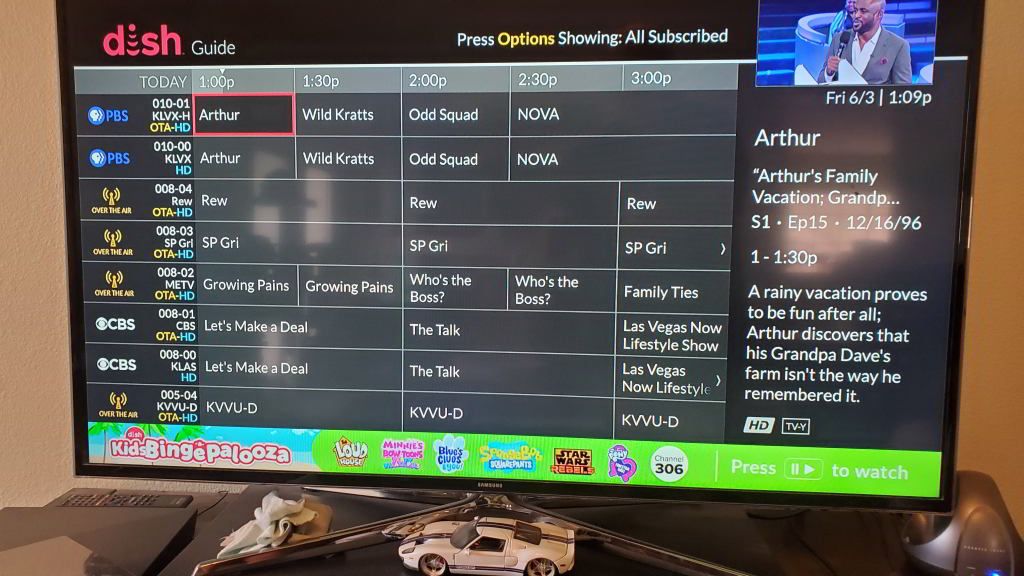

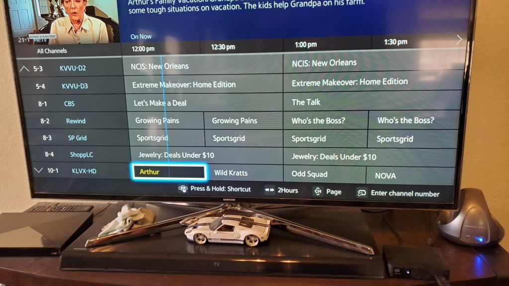

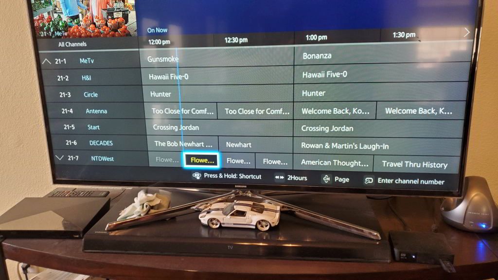

There has been a shuffling of OTA networks in Las Vegas. The two that I know of are that MeTV moved from 8-2 to 21-1 and H&I from 21-1 to 21-2. There may be others.
This means two things
1. Channel/network mapping in the Guide needs to be updated.
2. The guide info for most of the subchannels has not listed programming for many - e.g., Heros is displayed across hourly time slots. But... MeTV always listed correct programming info for 8-2. It would be nice if at least the time correct info for MeTV was also moved by Dish.

Hi Brittany, I can't seem to attach pictures to the personal message thread but they do seem to attach here.
The 8/21 shuffle happened on 1-Jun-22. This was when MeTV moved and both 8 and 21 shuffled their programming into other slots. 8-2 was MeTV and became Rewind TV. . 21-1 was H&I and became MeTV. 21-2 was ? and became H&I. I don't know if either grid's content is correct for the other subchannels of either 8 or 21. I would expect that somewhere there is an official definitive list of what is going out over the air but I'll be danged if I can find it :) It would be nice if Dish could also fill in the programming info for some of the others that just show anonymous 1-hour blocks. Some of these channels are actually carried on dish so their programming is known.
Thanks!
Edit: Removed pic with receiver info. Left the grids so others can see since accurate grid info is an ongoing topic :)
