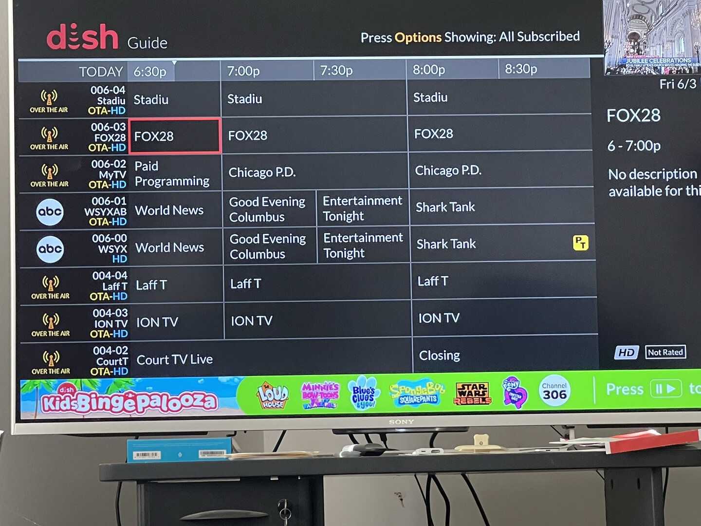

I don't know how to attach a picture to a private message but I have attached pictures of the guide to the forum.

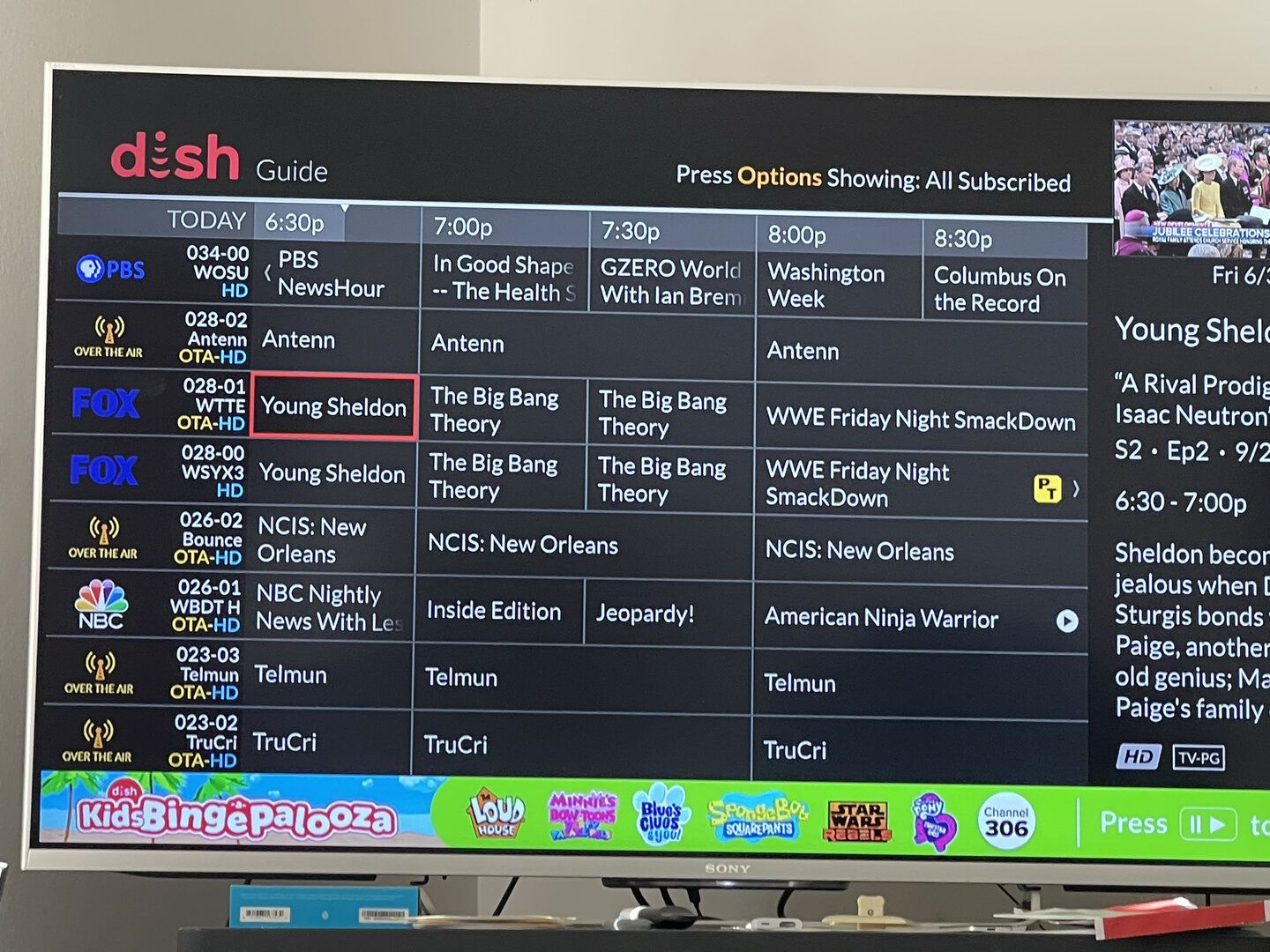

Img764 shows that Dish does recognize that Fox 28 is now broadcast on channel 6-03. Unfortunately no Guide information.
Img765 shows the Fox 28 guide information on channel 28-01. However 28-01 is actually TBD.
These changes occurred on January 8, 2021 so the Dish Guide has been incorrect for16 months.

A lot of the problems have occurred in markets that have implemented Nextgen TV (ATSC 3.0) broadcasts. They will appoint a "lighthouse" station to continue the existing ATSC 1.0 broadcasts while one station takes over the ATSC 3.0 broadcasts. This frequency sharing will continue for a minimum of 2 years. Dish should be able to remap their Guide but they don't seem to be in a hurry to do it. I appreciate the Dish technical support gal who is trying to fix the problems.
A slight correction there, as Img764 shows that the Dish receiver doesn't recognize what is being broadcast on channel 6-03. That is why the one-hour blocks simply mimic the channel ID from the PSIP. (The channel labels on the left side of the guide are what the station is actually broadcasting in the PSIP, and is the only part of the PSIP that is used by the Dish guide.) This happens for any channel where Dish doesn't carry the guide info, or where the receiver does not recognize which guide data stream to use.
Img765 shows that Dish themselves do recognize that Fox is now on 6-03, since they replaced the feed they use for channel 28 with the 6-03 feed, and labeled it WSYX3. However, the guide mapping is still wrong. So, the department that handles local channel carriage on satellite, and the department that handles OTA guide information mapping, evidently do not communicate with each other.

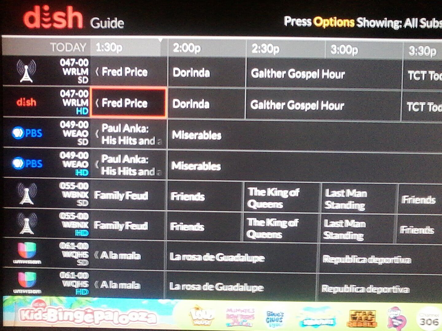

Here is one for the Beaumont/Pt. Arthur ,Texas DMA.
The ota Fox channel on 6.3 has NO GUIDE information and the old channel it was once on 4.1 ,which is now the DABLE channel ,has the Fox guide information instead. This means no one can use the correct ota Fox channel for name based recordings. This has been this way since the channel move was completed about a year and a half ago and YES, I have reported this to DISH tech dept. and to the station itself. The station engineer says it's DISH's fault and there is nothing they can do on their end. DISH has said to me "they will get to it when they get to it. "This is one change that would correct the area locals and put them back where they belong.
