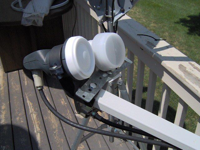

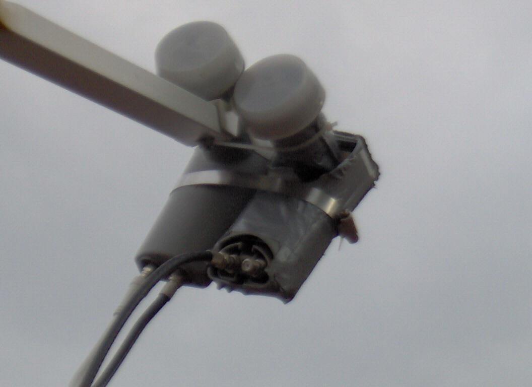

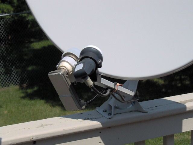

just get a couple DishPro LNB's for 110/119 and use a hoseclamp to clamp them together. You might have to gut the casing off one LNB to make it fit on the holder, but it works :)
I use to have LNB's for 123, 110, 119 on a single 30" dish (123 was for my FTA system)
Here is a couple pictures. 1st is 123/119 hoseclmaped. 2nd is my current 123/119. Note the masking tape to fill in the holder. MOst 30" or larger dishes ahve a adapter to fit in the LNB holder for the smaller lNB :)
