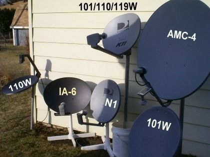

A pole in a bucket may work, but if the wind catches it the dish will move or end up in the next state! Its more temporary fix. I have one here I use now and then but I never leave a dish on it full time just in case.
I love the floor fan stands :).
