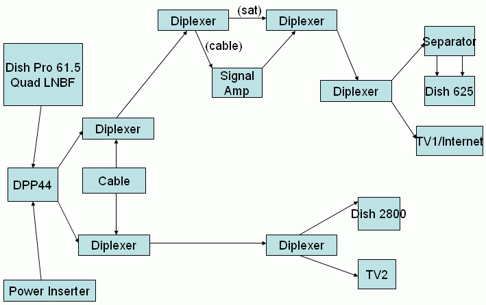

So it's all set up now and everything works great, even the two tuners in the 625. So right now I've got a 625 (2 tuners), a 2800, and cable (Analog, Digital, Internet, & HD) all working fine. The cable amplifier and the 625 line is using Holland Blue diplexers and the 2800 is hooked up via PVDP3 diplexers. The DPP44 is being powered by a clean line from the house and the LNBF is going into port #3 in the DPP44 (for 2800 61.5 compatiblity according to the DPP44 quick fact sheet).
Here is a diagram of what I did:
