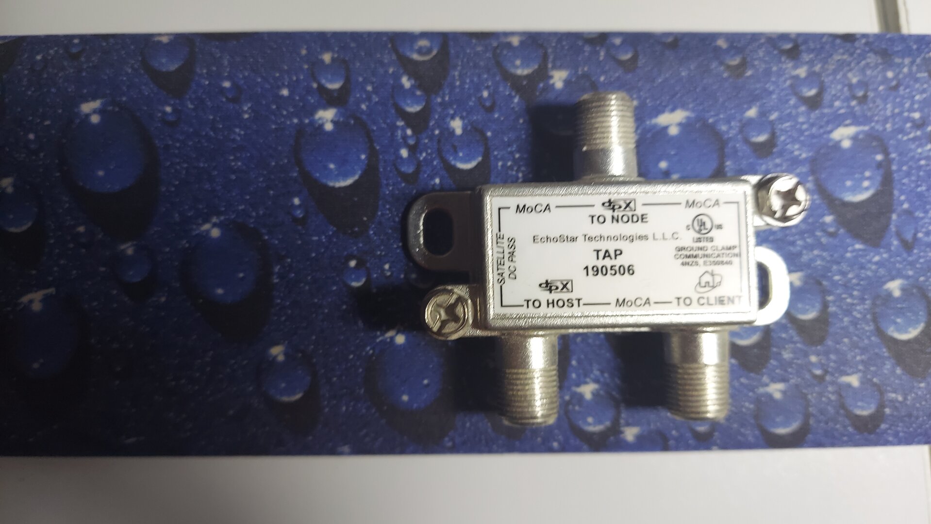

There is a device called a tap (190506) that can be placed between the node and the Host (H3) to add a client (Joey), but either way there is a bit of work to be done in the attic or wherever the node is. Either replace a single node with a dual or insert a tap between the Hopper and the node. Replacing the single node with a dual requires no cable splicing.

There is a device called a tap (190506) that can be placed between the node and the Host (H3) to add a client (Joey), but either way there is a bit of work to be done in the attic or wherever the node is. Either replace a single node with a dual or insert a tap between the Hopper and the node. Replacing the single node with a dual requires no cable splicing.View attachment 158006

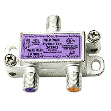

Just don't use this particular tap, It doesn't work with Hybrid Systems.
This is the correct Tap that works across both DPP and XIP Systems
