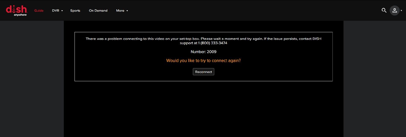

First, the streaming aspect works on both in DA when you click the streaming toggle on. The streaming channels work just fine. However, when going to the guide and clicking on a live program or going into the DVR section the following happens:
The black window comes up and it says connection and shows the animated icon. Then one or both of the following happens:
The picture attached comes up with the error.
If the reconnect button is clicked, the connecting icon will come up again and then the black screen area where the picture should come on goes black and there is no picture. If I move the mouse pointer into the area the 2 buttons that are in the top left and right corners do appear, but still no picture. Sometimes, the error does not come up, just the black screen issue.

Did not work. I cleared cache after logging out on google chrome. I am not getting the error message which I attached to my first post. It is now giving me the Connecting to your receiver message then the Starting Stream message (second part of my description above) and then going black as described. This is what has been happening for a few days now. The guide and buttons below and menu at the top still shows as always. Just a black area where the picture should be.
I also went ahead and did the same thing using Vivaldi just to check. Same problem.
