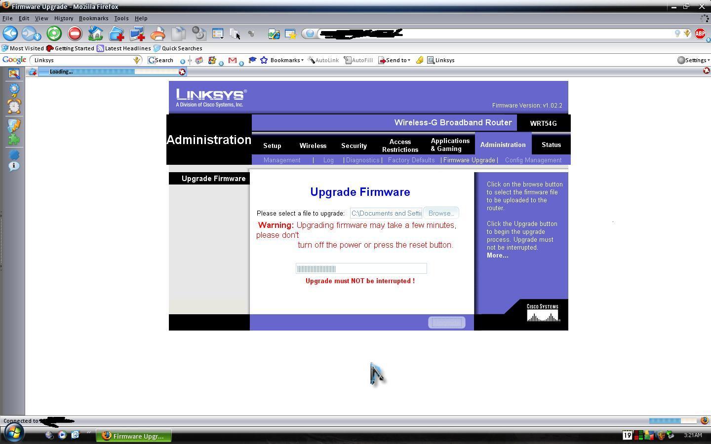

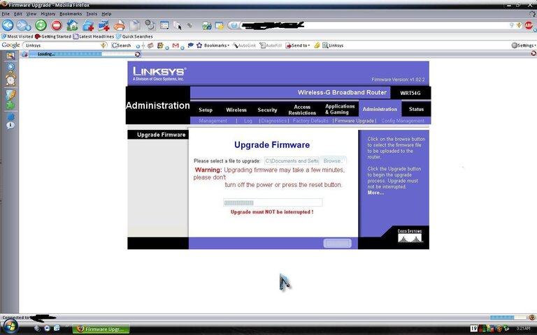

Go to the Linksys web site, click on downloads(Top of screen), pick your router, download your firmware.
Now go to your router and click on firmware upgrade, select file you downloaded and you are done.
Funny thing is that when I was writing this I realized I need to upgrade my firmware.
Here is a pic of my upgrade page.
