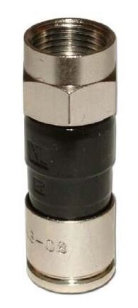

RG-6, plus all questionable connectors were replaced with PPC Outdoor Compression Connectors like this one:

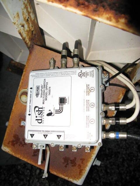

As I mentioned above, I have a Dish Network VideoPath Multi-Dish Switch Model DPP33 (see photo)

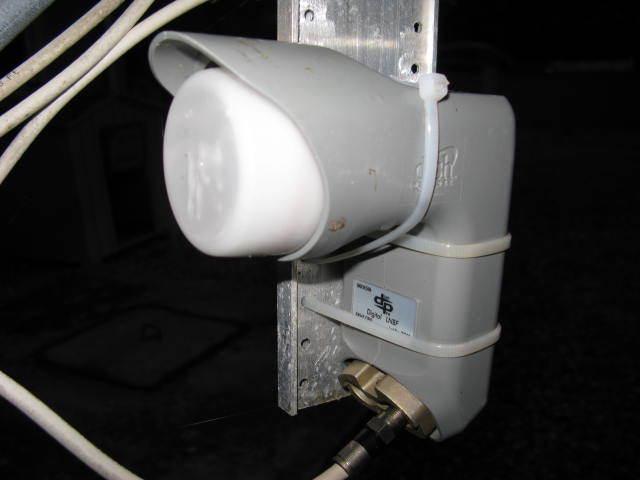

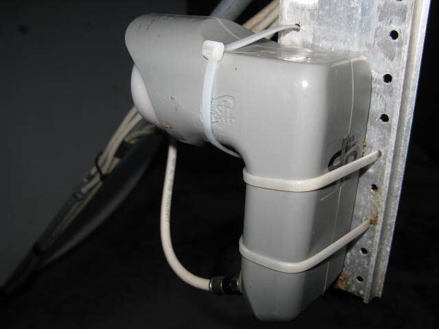

Are you sure? I bought all of my equipment (well, everything except for the dishes) from an authorized Dish dealer in the States, and I'm using what he said I should buy. Plus, I've seen others here using the same stuff as me. Here's some pictures of one of them (although this is the one that I'm using for 110 - the 72.7 dish is on a much higher pole, but it has the same LNB):
I was really hoping that someone might see the pattern that the transponders have and immediately be able to say "oh yeah, I've seen that before, you need to do this...". However, I also realize that problems like this can sometimes be very difficult to pinpoint.
