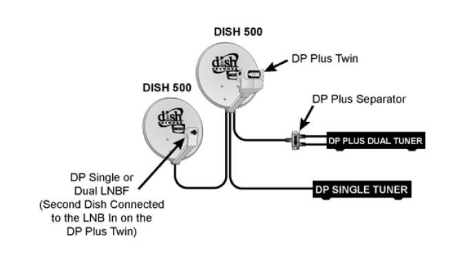

In the attached picture how do I add another Tuner/Receiver? Since both the connections from the DPP twin are used.

You'll need a switch to add more receivers. You'll need a Dpp44 switch and it will give you 4 outputs but they are expensive $180. A 1000.2 dish will give you 3 outputs and they cost $89.

Are both the connections from the DPP Twin going to the dual tuners in your 622? It should be hooked up with only one cable into a DPP Separator (looks like an oversized spliiter) I think. That would give you the extra line from your DPP Twin to your 211
He currently has two receivers, a 211 and the 622. He needs a switch or a 1000.2 that has 3 outputs.
